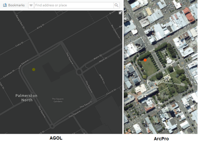

PANTONE colors are available in ArcPro but when you publish to AGOL it does not keep the same colors.

Hi Color in ArcPro is Pantone Orange 012 C

MarkPN
Hi Russell,
By unchecking that option it does keep the symbology in the New Web Map Viewer, But it did not work in Web Mab Viewer Classic.
To get it to work that option need to be unchecked and the New Web Map viewer needs to be used.
RussRoberts
Yup that is correct, new Map Viewer supports complex symbology and colors. This color is stored under the CIM symbol info in the web map and works in any of the web apps created with the 4.x JSAPI. Classic viewers like Map Viewer and other 3.x JSAPI apps like WAB will not support this.
