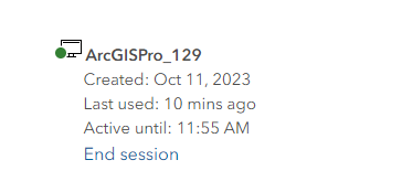

MattReeves_SpokaneValley
There is an 'End session' under the Licenses tab (for Admins). Would that accomplish what you are trying to do?
BethanyHodge
That's a really good thought, thank you, but the end session option seems to only be available if the license is online. I need a way to revoke an offline license.
