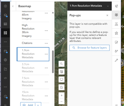

For example, to disable a MAXAR popup from the Living Atlas World Imagery basemap - I have to go into the basemap and turn off each metadata layers popups individually, for every single map I have this on, which is all of my organizations maps...rather time consuming. It would be great if I could shut off pop ups for a basemap altogether with one button instead of 15.

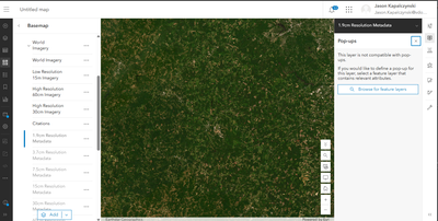

I have noticed with the October 2025 AGOL update - there is no longer an option within Map Viewer to turn off pop ups for world imagery, even though basemap pop-ups are still showing up when I click a random spot on my map.
BernSzukalski
There was a glitch introduced in this workflow with the October 2025 update. A recent patch has corrected this, you can now go into any basemap layer with pop-ups and disable those.
