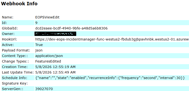

I have added a webhook to a view of one of our feature layers so that I can get notified when changes are made to any of the features (trigger featureEdit). This webhook appears to work... oddly... for lack of a better phrase.
Here is the setup:
This seems to suggest an interval of 30 seconds after changes are made, but in reality, I've seen times from four to ten minutes, which seems crazy for a webhook. I'm guessing this allows for more changes per response, which is fine, but still rather slow.

I reviewed your Esri Community post and took a close look at the structure of the triggerJSON.txt payload you shared. I would like to provide some initial architectural insights regarding the specific behaviors you are encountering, which should help clarify how ArcGIS Online handles these events natively:
1. High latency (4–10 minutes delay):
Unlike immediate transactional webhooks, feature layer webhooks in ArcGIS Online operate on an internal batch-processing scheduler. Editions are grouped and dispatched based on an internal server cycle (controlled by a background property called scheduleInterval, which typically defaults to a 5-minute polling window). If there is a high volume of server events queued in the organization, this processing interval can extend further.
