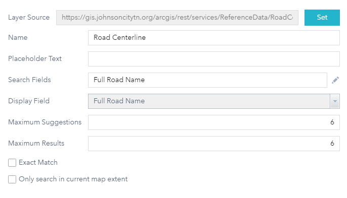

I have Web AppBuilder's search widget set up with several "search sources" including geocoding services and map services. Most of them work as expected, but our roads' map service does not return results when used through Web AppBuilder.
As I type in a road name, suggestions appear, but when I click on the suggestion, it says there were no results. The same happens when I type in the full road name and hit enter. I've tried searching for multiple roads throughout our area, but, while all of them return suggestions, none of them return results.
If I load this same service into ArcMap, the Find tool has no issues locating and zooming/panning to the requested feature.
Any help identifying the problem would be greatly appreciated.
The service is located here:
ReferenceData/RoadCenterline (MapServer)
The parameters for the search widget:
