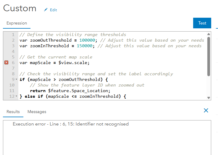

Hello,
I am having an issue where I am creating an Expression for a Label of a Feature Layer within Map Viewer Classic. I am trying to have the expression change which attribute is labeled based off the map scale. However, I am running into an issue where the expression does not work because of an Execution Error - Identified Not Recognized on the $view portion of my expression.
Within the ArcGIS Arcade Documentation, it shows that $view is able to be used as a profile variable within label expressions. If that is not the case, can someone explain to me why or if there is a workaround?
Yes the expression above might be flawed in general, but that is fixable if the $view issue can be solved.
Thanks

Hi Noah,
Thank you. I am using the Map Viewer Classic because we have an application that is built in Web App Builder and has not been migrated fully to Experience Builder. I have taken a look at that documentation, and I also found this blog post with similar functionality for the $view.scale (though used for Symbology, not labeling).
Within that documentation, there is a variable created that is: var cs=$view.scale. This should be the same way to create the variable structure needed for the labelling I am trying to do.
Can you share more on why you think the view is used incorrectly or how you would adjust it to work properly?
