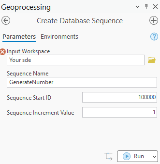

Hi @Rune_Van_Severen,
The issue lies on line 9 where you simply need to replace the line with NextSequenceValue(<name>).
Note: You need to run the "Create Database Sequence" tool in prior to running the updated line of code.
and then in the line update it with the name as shown here. NextSequenceValue(GenerateNumber)
