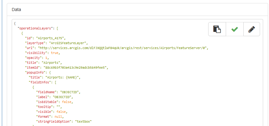

Hi Jose,
The AGO-Assistant can do this.  Select the option 'View an Item's JSON'.  You will have an option to edit the web map's JSON:
