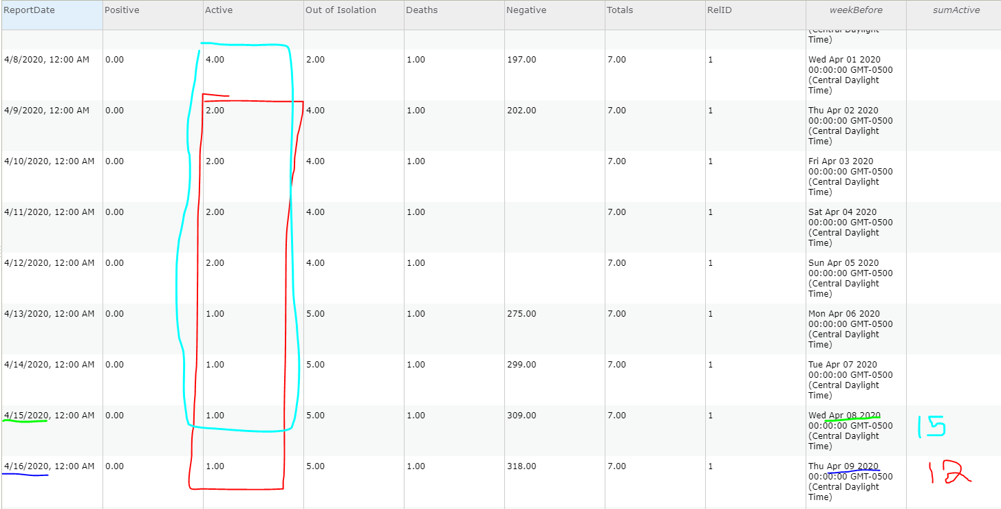

I have a arcade formula that gets a the previous 7 days date but how do I sum the values of a field based on the rolling date range? Xander Bakker
var startDate = Date($feature.ReportDate);
var oneWeekBefore = DateAdd(startDate, -7, 'days');
IIf(($feature.ReportDate <= startDate && $feature.ReportDate > oneWeekBefore), Sum($feature.Active), 0);
