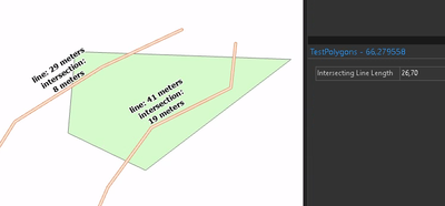

JohannesLindner
MVP Alum
You can use this expression as Attribute Rule (triggers on Insert & Update) or in a popup:
// load the line fc
var lines = FeaturesetByName($datastore, "TestLines")
// get all intersecting lines
var i_lines = Intersects($feature, lines)
// for each intersecting line, get the length of the intersection, accumulate
var total = 0
for(var line in i_lines) {
    total += Length(Intersection(line, $feature))
return total
Have a great day!
Johannes

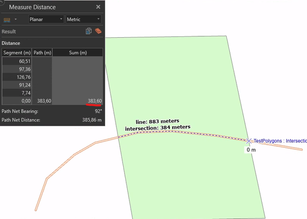

JohannesLindner
MVP Alum
Take a look at Intersection().
For example:
Calculate a field in the line feature class:
var polygons = FeaturesetByName($datastore, "TestPolygons")
var polygon = First(Intersects(polygons, $feature))
if(polygon == null) { return null }
var i_line = Intersection(polygon, $feature)
return Length(i_line)
Label the line with this expression
`line: ${Round(Length($feature))} meters\nintersection: ${Round($feature.DoubleField)} meters`
Result:
Have a great day!
Johannes
MikeZuege
Thanks for the help.  Ultimately, what I am looking for is to be able to modify the boundary shape (urbanized area poly) and return the sum of each of the functionally classified road lengths.

MikeZuege
Thanks so much!  What I am trying to do, is to create a popup for the box and have it populate the total length of the lines that run through the box.
JohannesLindner
MVP Alum
// load the line fc
var total = 0
return total
Have a great day!
Johannes
