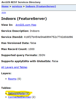

@ScottMoore__Olympia_  I am trying to do this process on a table and getting an error on step 6 when trying to make the editor tracking fields editable.  Its throwing a list index out of range, so I assume the fm = arcgis.features.managers.FeatureLayerManager.fromitem(item, layer_id=0) isn't setting the layer correctly.  Any ideas what would allow me to set that table layer?
sirws
New Explorer
@PeteAtwood Is the ID of the table 0 when you look at it in the service directory?  I never tested this on a table, but I would expect it to work.
PeteAtwood
@sirwsThat is a great thought, when checking I notice the index is at (2) for that table.  However, after changing the index to:  ...(item, layer_id=2) still getting the same result with index out of range.  I suspect "arcgis.features.managers.FeatureLayerManager.fromitem" might not be the correct code to set that table but I don't code enough to be able to figure this out.

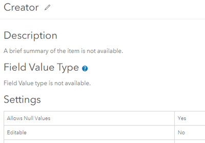

Found a workaround for this, if you go into the layers data tab - fields view (online), you can click on the Creator field and set the Editable to Yes.  It will then allow you to bring the table into ArcPro, calc the Creator field, then go back to the data tab and reset Editable to No.  I then ran the last line of code to re-enable editor tracking and everything is working as intended.  Kind of a pain but it works.

Hi @PeteAtwood
When I'm on the screen that you are showing, there is no option for where to make Creator editable. It just shoes "no". Am I missing something? Thanks!
@LLyons If you want to make the field editable in the UI, you would have to run the code above down through line 24.  That turns off editor tracking and makes the edit tracking fields editable.
