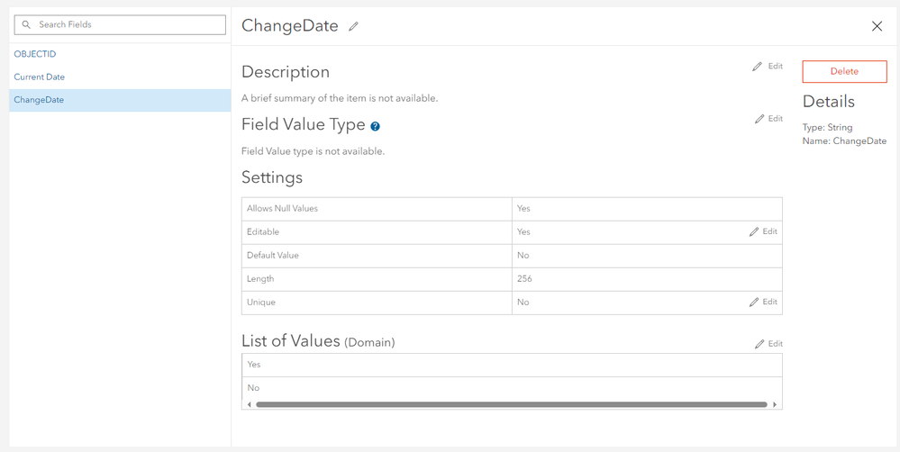

Step 1 - Update your data schema
Note: This workaround may impact your data model as you may need to add a new field to your layer.
  1. For a new editable layer or an existing layer, add a new field of type String
    • Give the field a name (e.g. Change Date in the sample layer)
    • The field must be Editable
    • The default value for the field should be "No"
  2. Add a List of Values (domain) for the field.
    • Values should be "Yes" and "No"

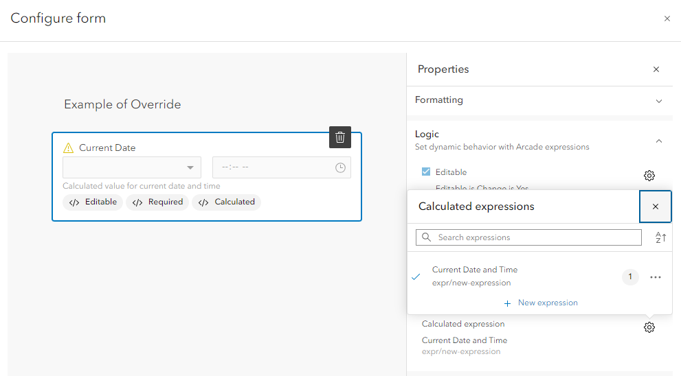

Step 2 - Add the calculated field to the Form
  1. In Map Viewer or the Field Maps Designer app, create a Form for the layer.
  2. To the Form, add the field for which a value needs to be calculated (e.g. Current Date in the sample layer).
  3. Under Logic, define the Calculated expression using Arcade.
    In the example below, the expression Now() will automatically populate the current date and time into the Current Date field.

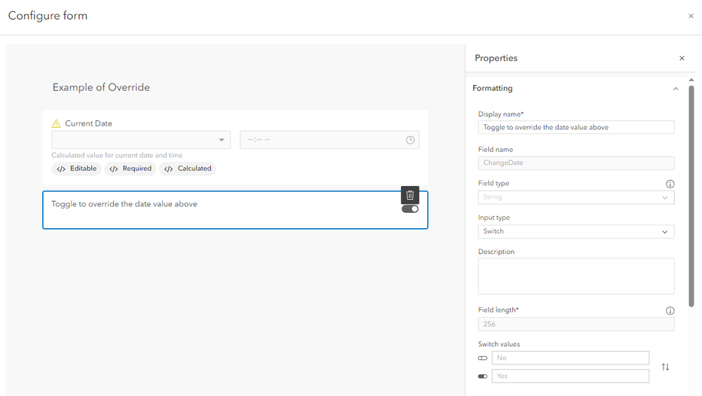

Step 3 - Add the conditional field to the Form
  1. To the Form, add the field that end-users will use to make the Current Date field editable (Change Date in the sample layer).
  2. Under Formatting, update the Display name for the field (e.g. Toggle to override the date value above)
  3. Change the Input type to Switch.

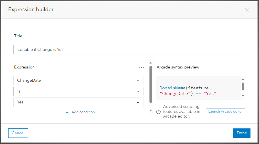

Step 4 - Add Logic for the calculated field
  1. For the calculated field (Current Date), under Logic, check the box for Editable and configure a new expression. (e.g. the Current Date field becomes editable if the Change Date field value is "Yes")
  2. Optionally, add an expression to make the field required if it's blank.

@WetherbeeDorshow
So you would have a calculated expression against the CurrentDate field (unless you only want manual entry to permit backdating in the first instance. The below will return the date and time if the field is empty (feature creation). If it is not empty (editing) then it will retain the existing value:
var cd = iif(isempty($feature.CurrentDate),$feature.CurrentDate,Now())
return cd
Then use the below conditional statement for editing against the CurrentDate field (which you can create without needing to write arcade in the expression builder (though it formats it slightly differently):
$feature.ChangeDate == "Yes"
