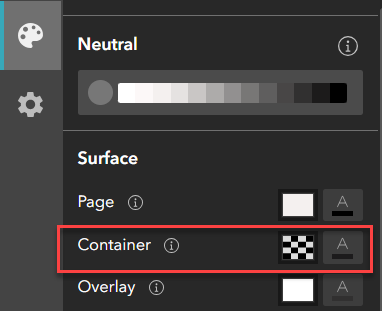

J: It was a lot of trial and error to get there, that’s for sure. I started by making my basemap slightly transparent. Then, I made use of the new ArcGIS Experience Builder theme settings to make the widget containers transparent.
DylanMurphy1_0-1767914610250.pngTransparent container in new ExB theme settings

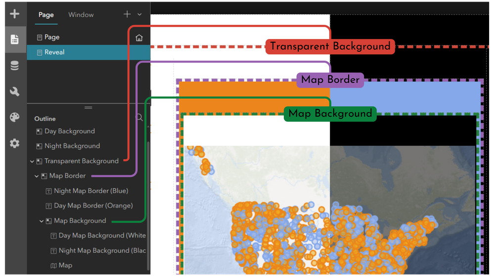

I once again used my patented maneuver of using empty text widgets to create color and stacked them on top of one another like a ziggurat. From top to bottom:
  1. Map widget
  2. Black and white text boxes for map background color
  3. Blue and orange text boxes for map border color
  4. Black and white text boxes for application background color
DylanMurphy1_1-1767914610316.pngUsing stacked text boxes and transparent containers to pull off an Opposites map in Experience Builder
Once I had solved the puzzle of figuring out how to do the bi-colored map, I then created the rest of the app to justify creating a bi-colored map. Which is more or less my process for my personal creative projects. I’m not looking to build an app. I’m trying to figure out how to do some weird idea and then the app comes secondary. Definitely not best practices for app building but works great as an exercise in out of the box thinking.
