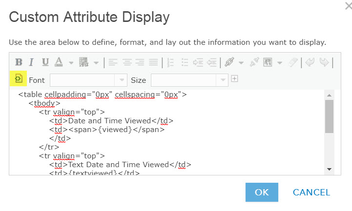

2. Configure a table using Custom Attribute Display in the pop ups that is configured to use the expression as the label.
        Custom Attribute
    - Enable the option to view Source HTML:
- Create a table using the HTML  sample below. The text in curly brackets refer to attribute values in the feature layer. The plain text between the first table elements specifies the label for each attribute.

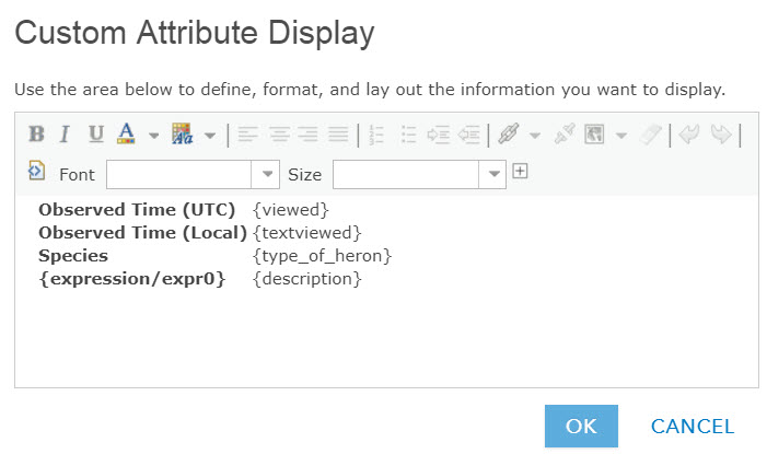

- Note that {expression/expr0} is the value of the Arcade expression created in Step 1 that is used for the attribute label and the description value is used for the value. If no value is present in the description there will also be no value for the label.
- Unselect the HTML Source option and your formatted pop up configuration should look similar to this screen shot:

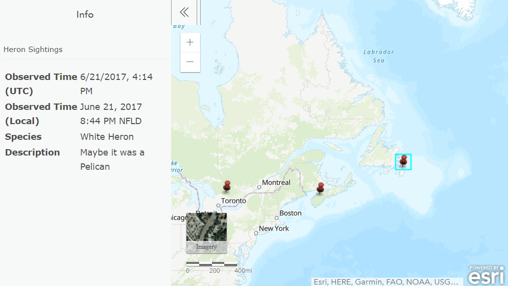

Description Values Present:

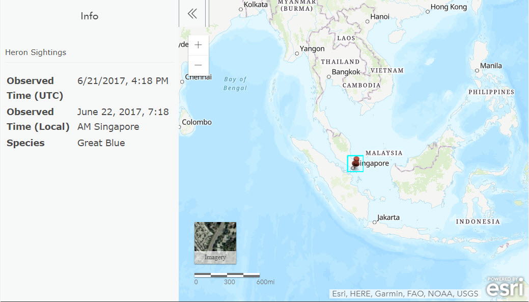

Description Values not Present
