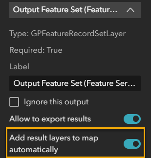

In Experience Builder, you can configure an output layer parameter to "Add result layers to map automatically". This option is usually toggled on by default.
