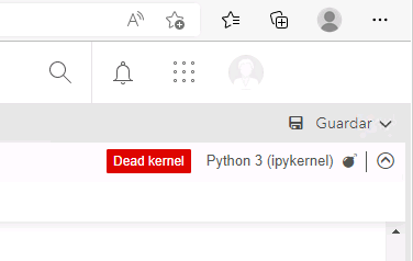

But if I try to use the arcgis (GIS, ArcPy etc) elements the kernel crashes.
Error message.
The kernel appears to have died. It will restart automatically.

The cluster of (3) host server where the end user has virtualized the Notebook VM has CPUs with AVX support (AVX, AVX2, and AVX-512), the drawback we are having is that the VM does not recognize it.
In the environment Tensorflow is not used and will not be used, and the issue its present just by importing GIS or ArcPy libs., the kernel stops responding.
From the tests it has been seen that the difficulty is related to the tensorflow-gpu component, which must be uninstalled; once it is uninstalled notebook can be used.
