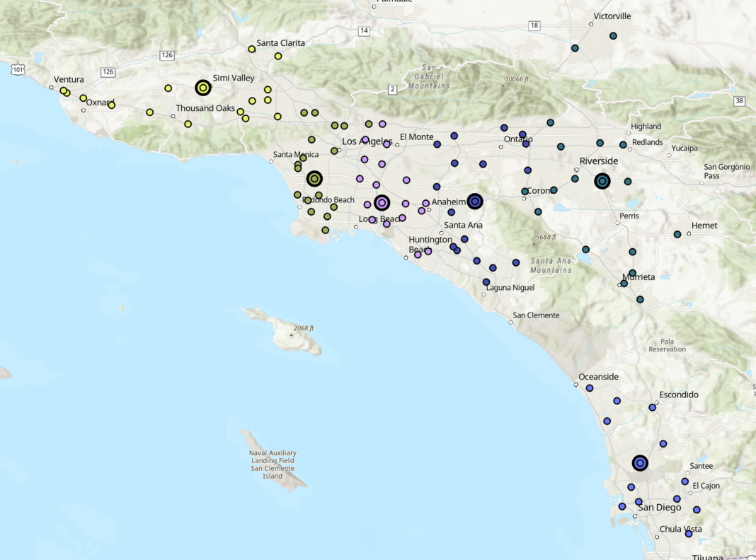

  • We have preidentified territories for reps (shown below) that range 13 to 18 stores and the rep location (larger point).

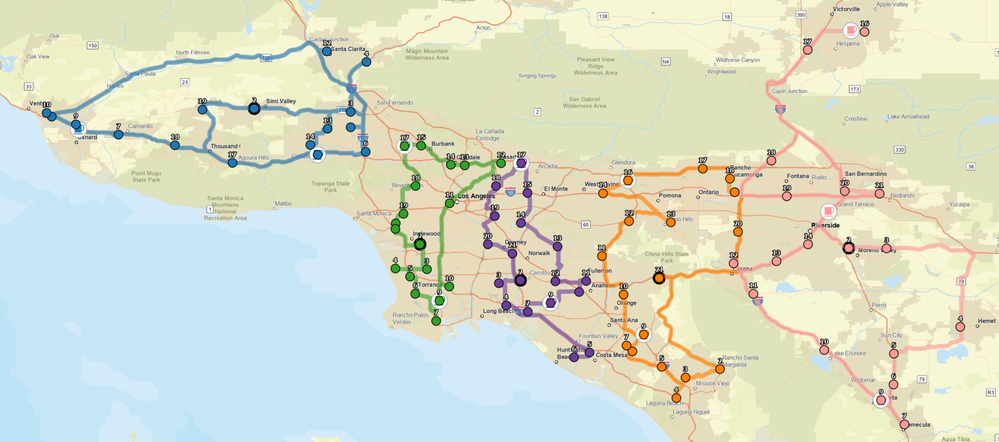

Update: As you can see in the screenshot below, breaks are currently being taken at random locations on the route. Is there a way for me to have the route go back to home location when it is almost the end of 480 mins of work. Then start the next day from the home location?
I guess I can do this by using sequence under the order and breaks feature class, but the issue is this becomes very manual driven.
I think it would be a good enhancement to have an option to return to home location when solving VRP. @MelindaMorang @HeatherMoe
