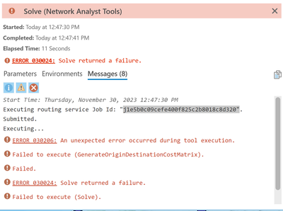

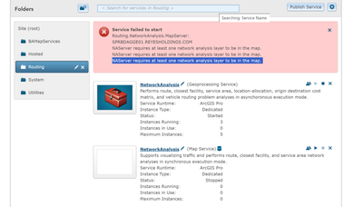

@MaxZeng Sorry for bothering you again.
The network analysis tools kept reporting this error. Then, I restarted the NA servers.
However, it reported this error. Do you know how to handle it? Thanks.
MaxZeng
@JunzheZhang , ArcGIS Pro uses geoprocessing service, so the failure has nothing to do with not able to restart your NAServer service. You can go to server log and see whether that job ID shows you any message. You could also construct the job url and look at the messages. URL will be something like https://<gpservice-url>/FindRoutes/jobs/[jobID]
If your NetworkAnalysis geoprocessing service is not Info level message, change to Info level message and rerun the analysis, that will have more log messages when you look at the job using that url above.
For the NAServer issue, not sure what is going on. Since the service was fine but have issue after restarting, not sure whether it is data access issue or something like that. See whether the server logs show more.
