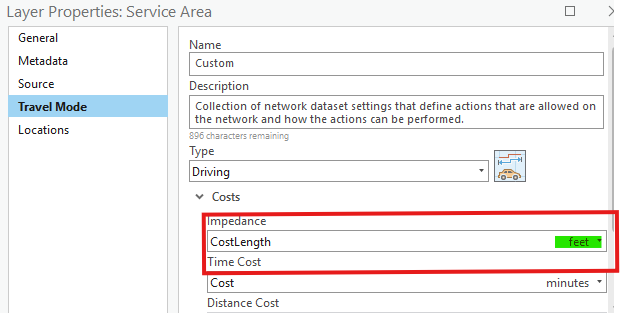

The below is the ArcMap UI for setting impedance in a service area layer:
Is there a way to set this in model builder?
Our county's central GIS office set up our network dataset and I can't change it. It includes attributes (fields) such as FT_COST, FT_SPEED, FT_MINUTES. FT_COST and FT_MINUTES are the same for most street segment - they both represent time costs. I need service areas based on distance (feet or miles), but model builder seems to keep defaulting FT_COST or FT_MINUTES. If I change the impedance in Pro to "CostLength feet" in the above screenshot, I get the expected results. One way streets and overpasses (F_ZLEV, T_ZLEV) are respected as well.
But I want to use model builder so we don't have to go through all of these steps manually. But I can't find a place to set the impedance to distance/length. Is this possible in model builder?

As you've discovered, there's no way to use a custom travel mode in a model.  You can only use travel modes that are stored permanently on the network data source.
Your Python script isn't working because "Feet" isn't the name of one of the impedance attributes on the network.  From your screenshot, it looks like the attribute is named "CostLength".  The "Feet" you have highlighted in the screenshot is the unit of measurement used by the attribute.  It's just there for informational purposes.
Here's the documentation for how to construct a custom travel mode object in Python: https://pro.arcgis.com/en/pro-app/latest/arcpy/network-analyst/travelmode-nax.htm
You're on the right track.
new_travel_mode = arcpy.na.TravelMode(travel_modes["Driving Distance"])
new_travel_mode.impedance = "CostLength"
