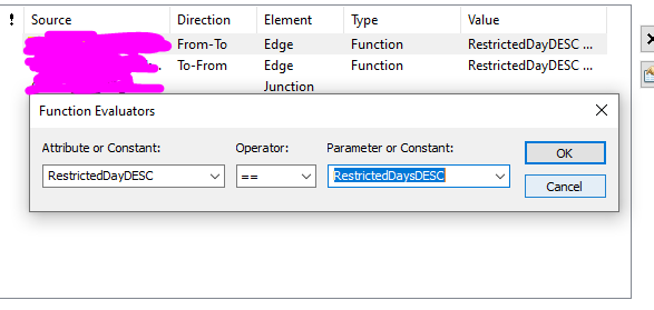

Then i added a restriction called RestrictedDays  (unknown units Boolean Data Type)
and a parameter called RestrictedDayDESC
Finally i created a function evaluator

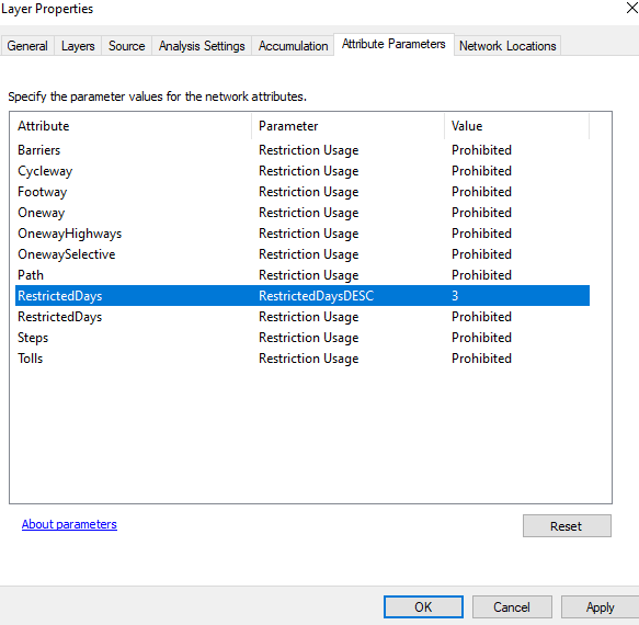

If i create a network analyst layer through arcmap the logic works. an i can change parameter value through Attribute Parameters tab
So far so good but we work with python and i cannot find a way to pass the current day parameter to
MakeRouteLayer method
