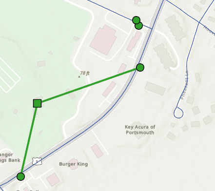

I'm running a cost analysis for pedestrian accessibility, but I've run into an issue. After running Solve on my OD Cost Matrix Analysis layer, I realized that multiple points could not find a destination, despite being well within my 3960 ft range. As an example below, the two origins (round icons) are only a little over 1000ft away from the nearest destination (square), following the network. The two origins that did connect to that destination, also have a route length of about 900ft; so, it doesn't seem like something weird is going on with how the destination is pathing to the network. Quickly scanning through my data, it looks like there's over 50 origins with similar issues.

The connectivity was the issue! The road in front of the destination had a little nub that extended past the end point for the road that the origins were on. So the network didn't view the roads as connecting. After splitting the road at the vertex and running it again, those are now connecting correctly. Thank you for your help!
