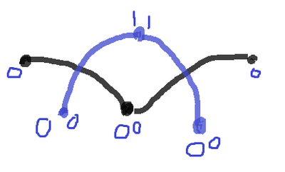

The key is that you need two fields, not one.  The field values represent the "level" of each endpoint of the feature.
For instance, let's suppose you have an overpass and underpass with endpoints at the location where they cross (four features total with eight endpoints).  Because your data is 2D, it looks something like this:
But really, it's an underpass/overpass situation, and you don't want the roads to connect where they intersect.  To do that, you need to add fields like F_ZLEV and T_ZLEV and assign them different elevation values to ensure that they don't connect.  For example, set the overpass values to 0 and everything else to 0.
The hardest part is figuring out whether to set F_ZLEV or T_ZLEV to 1 because the correct field to use depends on the direction of digitization of the street feature.  The F_ZLEV field describes the level of the "from" endpoint  (the starting point of the feature), and the T_ZLEV field describes the level of the "to" endpoint (where the feature ends).
