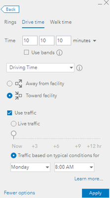

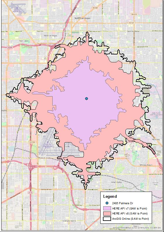

I assumed that Arc would be using the HERE API, but I cannot make the catchments match. The parameters don't exactly line up (ArcOnline offers traffic options for a typical Monday at 8AM, while HERE you have to specify a date). No playing with the parameters will make them the same

ArcGIS Pro and ArcGIS Online uses the Network Analyst extension to provide the routing and drive time polygons. It does not use HERE API. Network Analyst can work with any user provided network dataset. The ArcGIS Online logistic services uses Streetmap Premium network dataset that is based on HERE's street data. The results are probably going to be different as they use different approaches and perhaps the network dataset settings are different as well.

Thank you @JaySandhu for clearing this up, very helpful.
