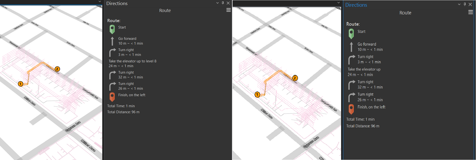

We recently started using ArcGIS Indoors Model and found a weird situation where directions' description leave elements when default configuration is altered.
For example,
Situation 1 -  Once Network Dataset is cretaed and a route is solved which includes a transision, description is "take the elevatio up to LEVEL #"
Situation 2 - When any part of this description is altered from Network Dataset > Properties > Description (It doesn't matter what you change, any slight change from default) will miss the LEVEL element from description. Descripton from Altered configuration is "take the elevatio up"
Attaching a side by side image for comparision:
@sri_krishnahari

Can you please post a screenshot of the network dataset property you're altering? I see the problem you're describing in the directions text, but I don't understand from your description of "Situation 2" which property you're changing.

when we try to modify any of the following changes, the capability to show directions on transition changes to 'Take the elevator up' and the level numbers never show up again irrespective of any other changes in the network dataset property. (Can be reproduced with the Indoor Product files, available in My ESRI downloads).
1. Add field in Pathways
2. Add field in Transitions
3. Confirmation/Turn tolerance changes in Landmarks
4. Any minute change in time/distance cost in pathways/transitions.
5. Enabling Hierarchy
6. Adding new sources in the network dataset ('Network' feature dataset).
Basically any property related or schema related change in the Network Feature Dataset is dropping this capability.
