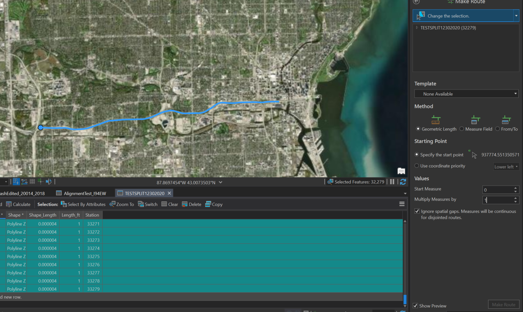

Hi There,
It is the first time that I am trying to create a route from a polyline in ArcGIs Pro 2.7.
It seems very easy but I was not able to do it. I was wondering where I am going wrong. Below is an screenshot of what I am trying to do. I dont know why the "Make Route" button does not highlight.

A couple years back the accountants convinced Jack that he was losing money with routes and linear referencing.  There was change made so some of that functionality was transferred to an extension, but the name fails me now.  However, try https://pro.arcgis.com/en/pro-app/latest/tool-reference/linear-referencing/create-routes.htm instead.  Not sure if that'll do what you want or not.

Joe, thank you very much for taking the time to answer my question, and yes, your recommendation did what I was trying to do.
