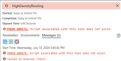

However, when I try to run tool, I get this error message.

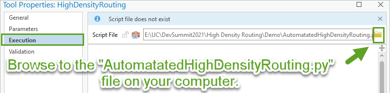

The script tool is looking for the Python script to run, but the path is out of date, not pointing to your copy of the script.
Open the toolbox and right-click the script tool and click Properties.
Click the Execution tab.

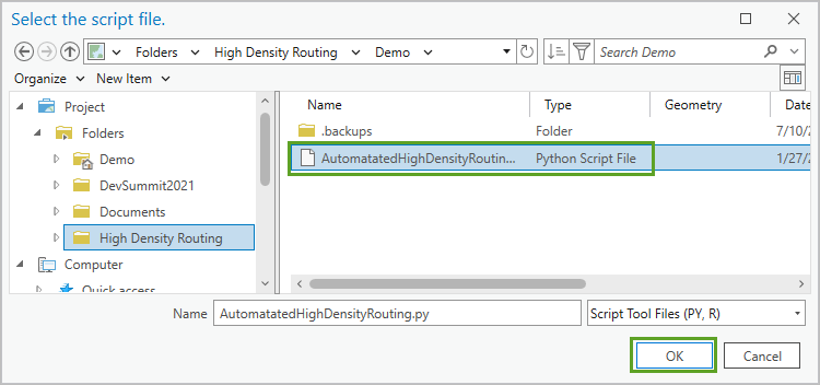

Click the browse button and browse to the location of the "AutomatatedHighDensityRouting.py" script file on your own machine.
Click OK on the browse window.
Click OK on the script tool properties.
Run the tool. It should work now.
