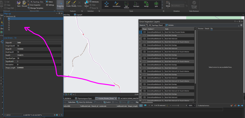

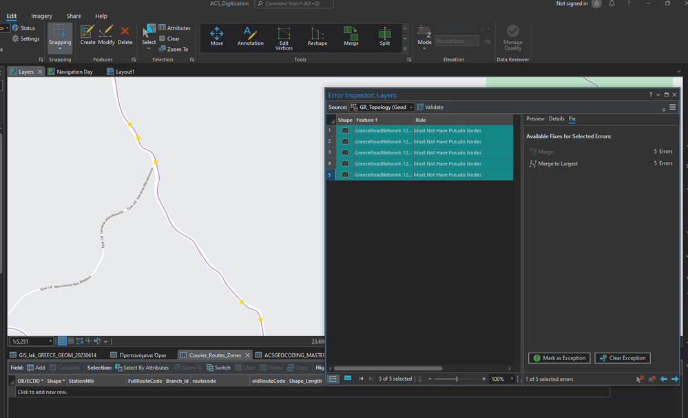

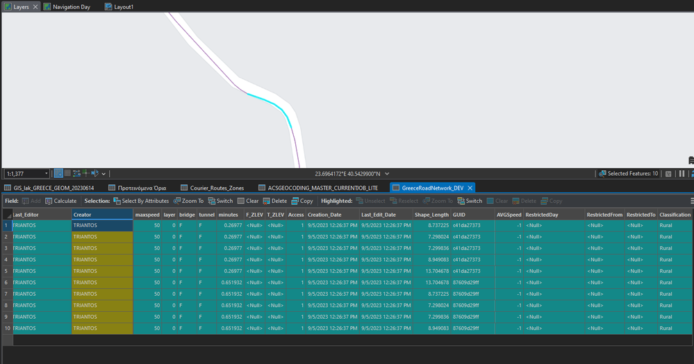

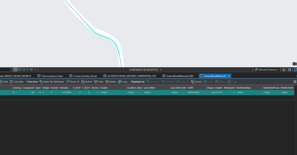

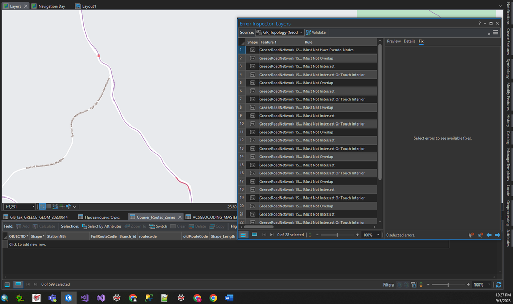

Hello there, I apologize for my delayed response. I spent some time observing how my colleague uses ArcGIS Pro, and I noticed an issue when they utilize the 'Validation Topology' and 'Merge to Largest' tools. The problem arises when there are more than three segments involved.
In the example below, we started with six initial segments that we wanted to merge into the largest segment. However, when we used the mentioned tool, it created multiple segments instead of merging the six initial segments.
Image 1: The segments we intended to merge.
Images 2, 3, and 4: Post-merge using the 'Merge to Largest' validation.
Image 5: The segment before using the 'Merge to Largest' tool.
