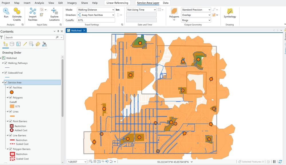

I am attempting to use network analyst to create a 10 minute walkshed in a fragmented sidewalk system. When I complete the service area tool, it defaults to using streets as the pathways, not the sidewalks that I would like. I have the sidewalk layer in my network database, and it is used as the edges in the travel attributes for costs (time). What am I missing that is preventing the analysis from utilizing sidewalks to create the walkshed?Screenshot 2026-05-27 095628.png
MelindaMorang
From your screenshot, it appears that your Service Area layer is using ArcGIS Online as the network data source, not the network dataset you created with your sidewalks.  When you create a network analysis layer, you need to select your network dataset as the network data source to use.  Here is some documentation that explains this in more detail: https://doc.esri.com/en/arcgis-pro/latest/help/analysis/networks/new-network-analysis-layer.html
