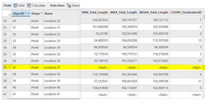

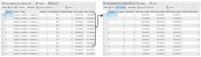

JanaWe
Thank you Melinda for your response and help!!
You answered my question. I was confused about the warning mesages not matching the actual result. rejoining the results with the origins works very well. I do attach a picture to illustrate for other community members who might get to a similar point of confusion.
Thank you !
Picture 1: Sumamrizing the statistics
Picture 2: Joining the statistics with the origins. highlighting the origins without any connection within the cutoff
