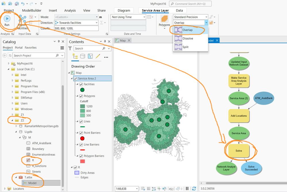

As per the screenshot below, the solve” tool in model builder produces results different from the “solve” button in the ribbon with same network dataset settings and configuration.
What could be the issue here?

It's difficult to determine what's really happening from these screenshots.  It looks to me like the results might be the same but with different symbology and different draw order.  I suggest you check the attribute tables of the resulting Polygons layers and check whether they are the same.  You can use the Feature Compare tool to compare the attributes and geometry exactly.

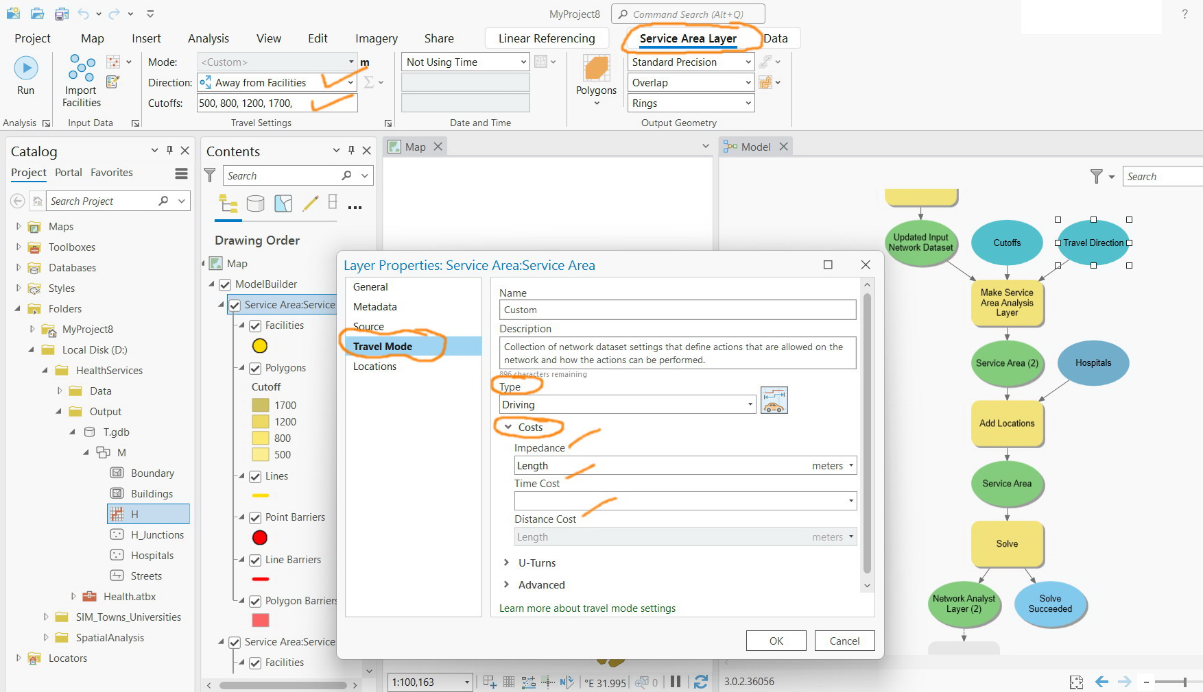

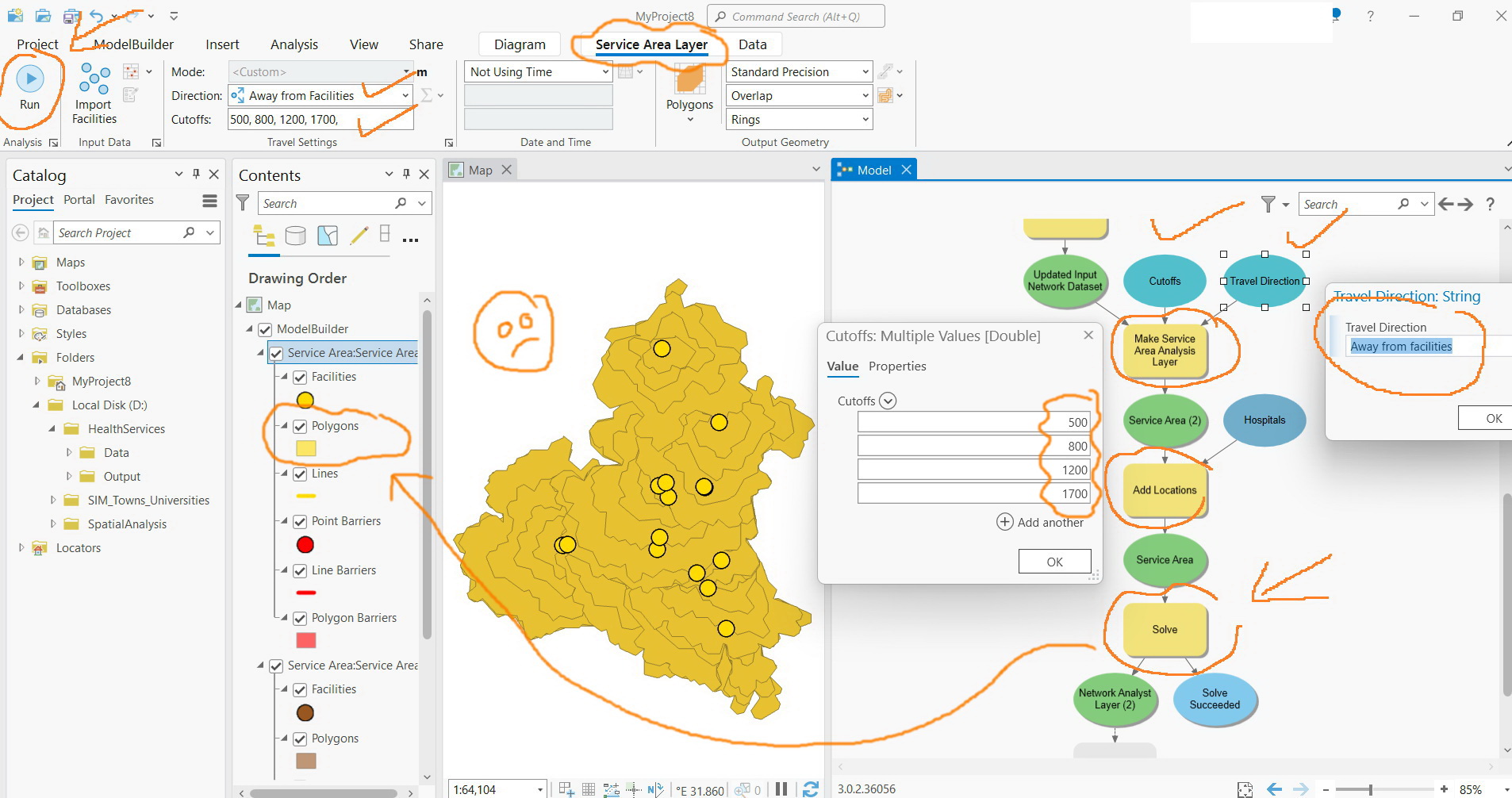

I tried all possible symbology ways to see if the result of the “solve” from model can be identical to the one obtained from the “run” from ribbon as the geometry option is set to be “overlap”, but failed.

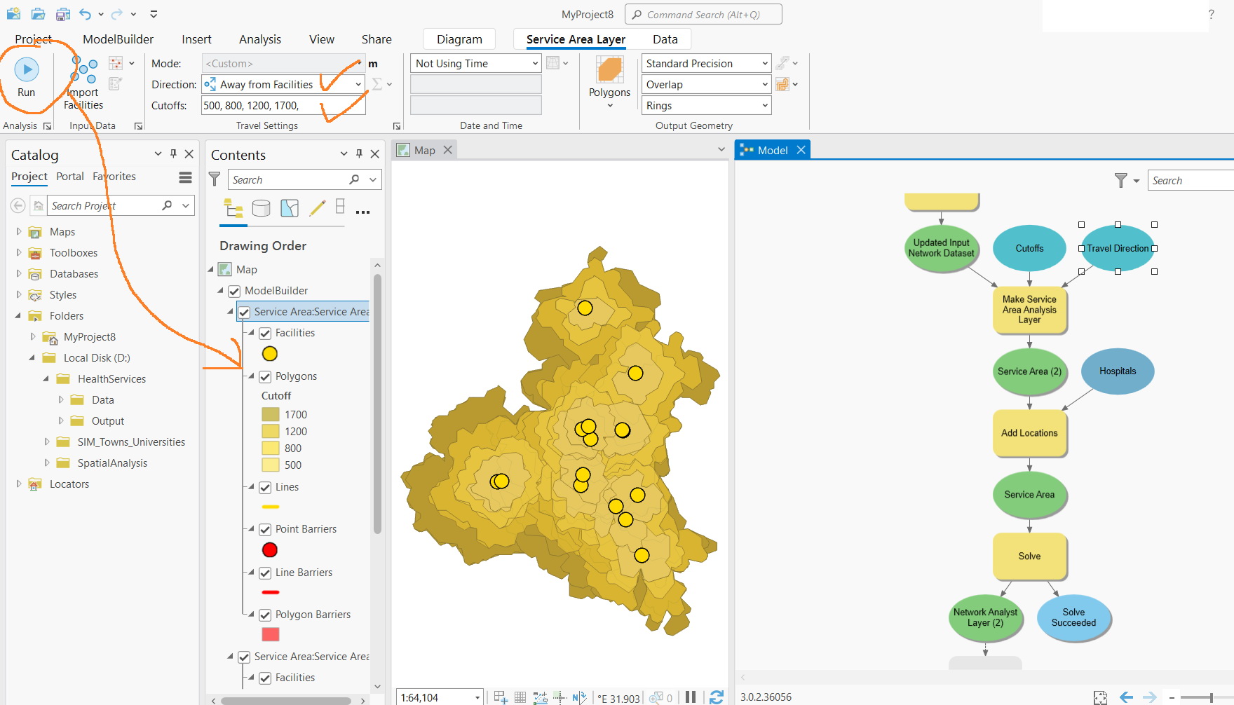

All what I wanted to do is to calculate the population size within the cutoff ranges of 500, 800, and 1200 meters from the ATM machines using the model builder.
What I observed is that the result that respresents the cutoff ranges is different if the “solve” is applied in model builder than the one applied from the “run” in ribbon particularly if the geometry option is set to be “overlap”.

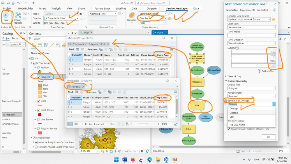

We can live with this behavior as the result obtained from the “run” tool in the ribbon and the “solve” tool in the model can be identical if the “geometry at overlap” option is set to be “dissolve” as per the screenshot below.
