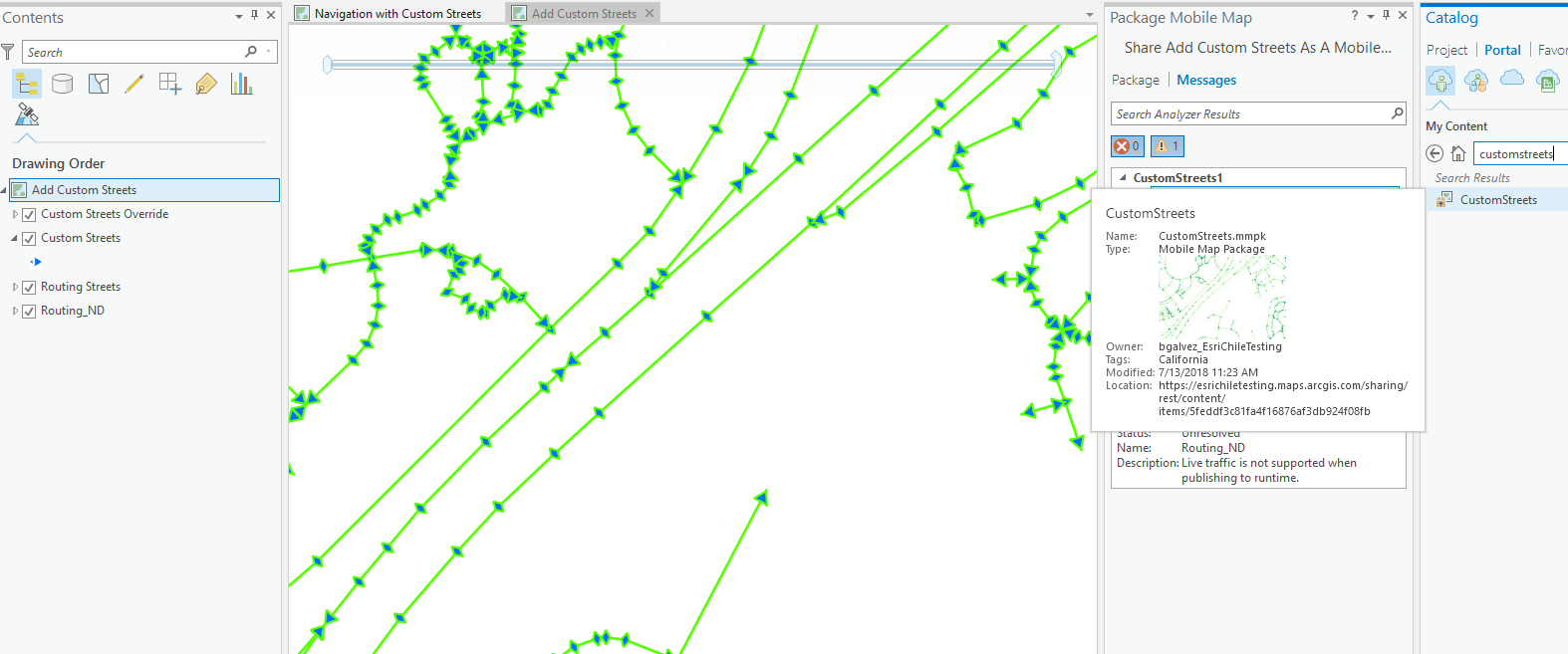

Hello Navigator Team.
I have a problem, because cannnot upload mmpk packages compatibles with Navigator.
I have this DEMO (Print Screen) but when share this package in ArcGIS Online or Portal, the mmpk create without problem, but when I see in Pro or NAVIGATOR App, is not compatible. (See print screen please)
It’s very important, because a Customer need update yours routes, using StreetMap Premium (as base).
This update, will perform in collector (offline), via WebMaps housed in Portal for ArcGIS on SQL 2016 (Registred and validate in datastore 10.6). Then, this changes (post sync) need see in Pro 2.2 (SQL received the update from field) and then, will need share package updated to Navigator. The package also is in Portal. Then, they will need using navigator offline in the field for that the workers arrive to yours destiny
Is possible implementing this solution?
What’s requirements previous should has the datasets for see and navigate maps in Navigator app?
I see this video, but I have not clarify mi question: https://www.youtube.com/watch?v=dK2L2b7aq_Q
I’m attaching the mmpk (For your reference).

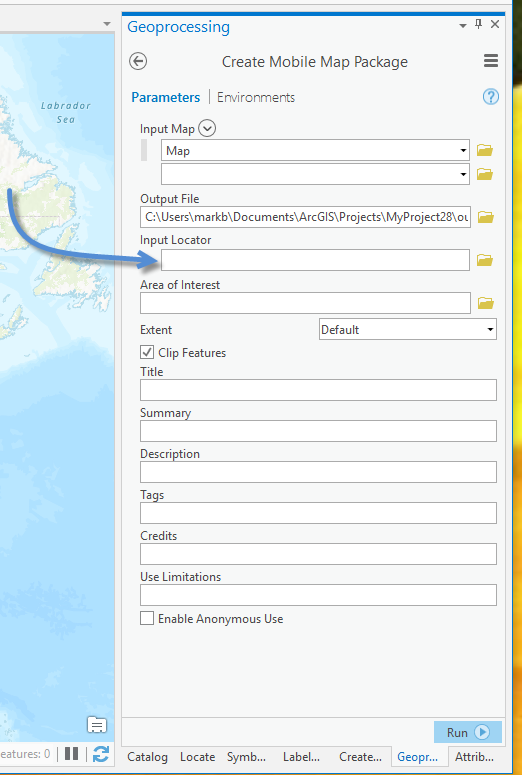

MarkBockenhauer
Did you include a Locator in the Mobile Map package?   Navigator will not open Mobile Map Packages that do not have a Locator and Network dataset.
