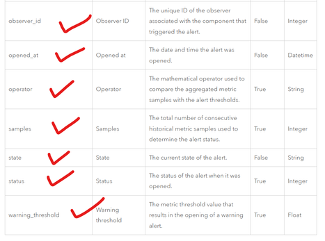

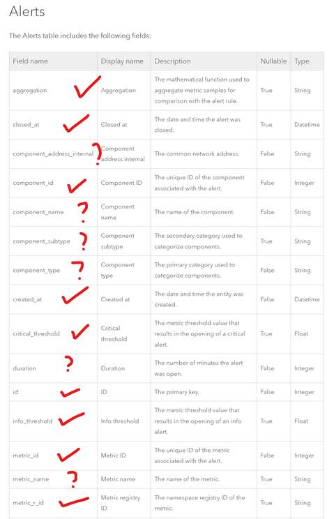

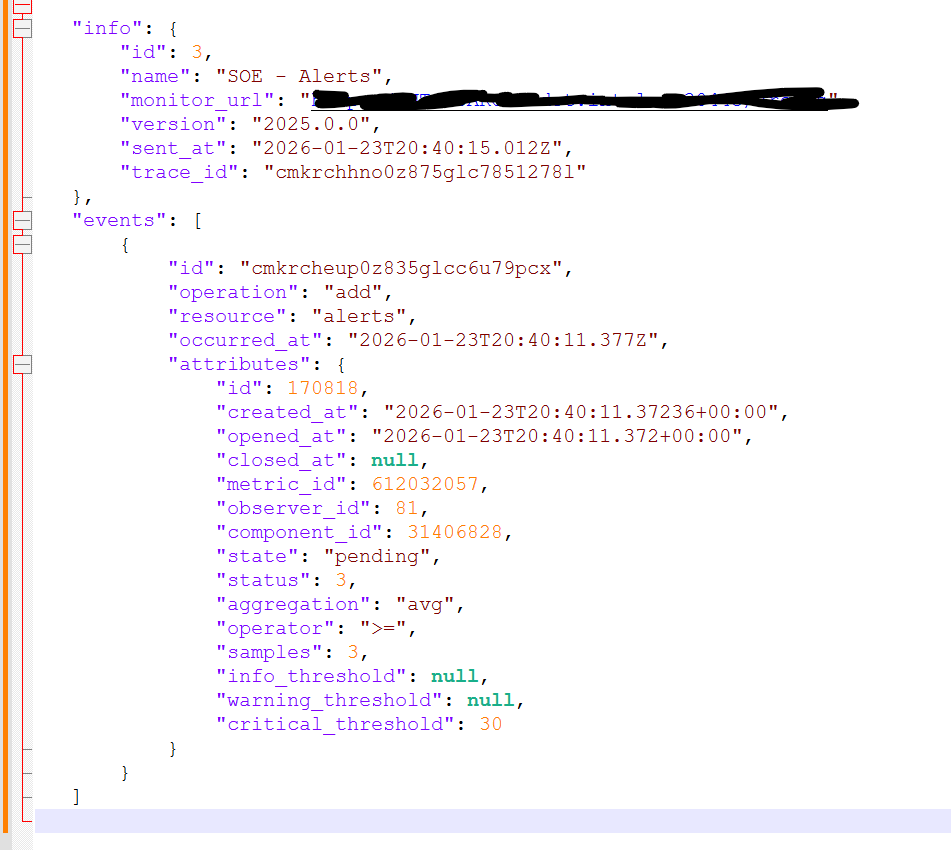

Hello,
we have enabled the webhook on a few notifications (Alerts) setup based on Collection. We are able to get the payload, but how do we get the name of the service that is causing the notification to be triggered? Below is a copy of the payload we are receiving
according to the documentation (ArcGIS Monitor Information Model—ArcGIS Monitor | Documentation) should the payload has more attributes? (component_name,component_type, etc..).

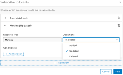

Hi @DominicRobergeIADOT
I'm on AGM 2025.1 and still see the attributes you do when the Webhook is configured with Alerts (Added). To get some more details try updating your Subscribed Events to also include Metrics (Updated).
Using https://webhook.site/ to test I now see some additional useful details in the payload.

DominicRobergeIADOT
@MarlonAmaya  Yes I had the documentation and below are the fields that are listed in the Alerts attributes and a bunch are missing

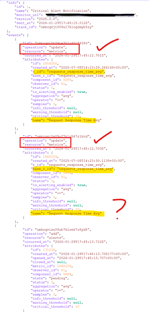

DominicRobergeIADOT
@StevenBeothy  thank you for the quick response
we are at 2025.0, our notifications are setup based on Collections, so I don't have the "Metrics" option available.
Is the Metrics option only available to Custom Notification?
I did create a dummy Custom notification, I was able to add the Metrics option, but I don't get the service name in the name attribute like you do....
What am I missing?
