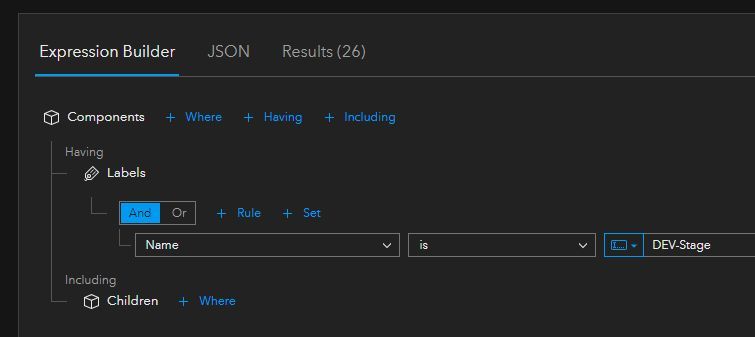

Tobias_Gerber
No solution for an automatic labelling but maybe a workaround:
Set 1 label only on the ArcGIS Server component itself ("Dev-Stage"). Create a collection for this label and activate "Including Children".
This way, all future services published on this ArcGIS Server will automatically be included in this collection.
