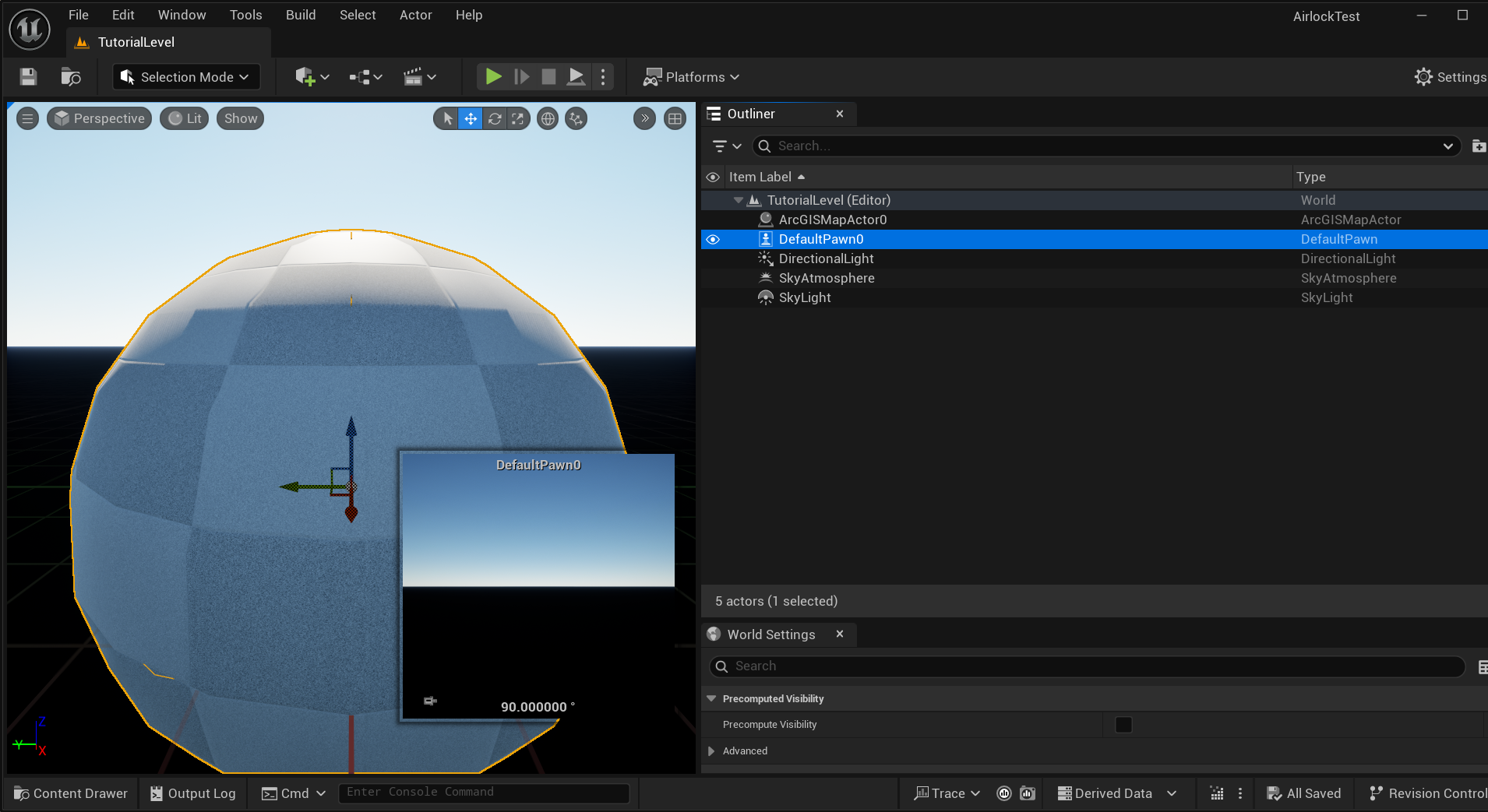

I'm working with Unreal Engine 5.5.1 and the ArcGIS SDK 1.7 on behalf of a client. I've been following this tutorial to familiarise myself with the software, but from what I can tell, I don't think the SDK is working as intended. Essentially, no map/scene is displaying in the UI:
I've followed the tutorial to a T, imported the plug-in correctly, and confirmed my API key works. All the basic checks. I even tried with SDK version 1.6 - no luck there.

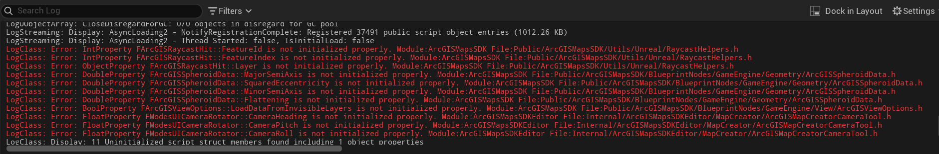

Whilst I'm relatively unfamiliar with the product, I went to the logs to see if I could get some hints as to what is malfunctioning, and I noticed the following errors:
It seems like a variety of header files aren't being read properly? I'm unsure if this is exactly what's causing the issue in the UI, but surely this should be remedied.
My question is: Has anyone heard of or experienced these errors before? And if so, how did you remedy it?

I believe those error messages can be ignored.
You could start by checking whether the samples work properly. After that, you could add a ArcGIS View State Logging Component to the ArcGIS Map Actor to get additional status messages in the log, which will be helpful for further debugging.
