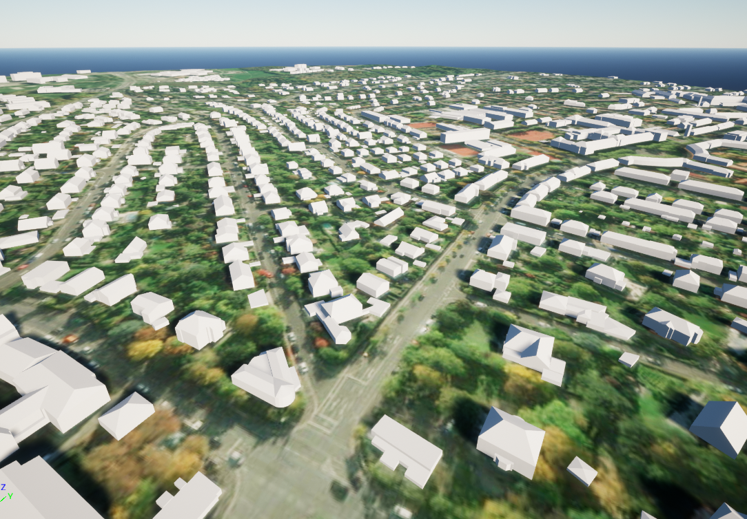

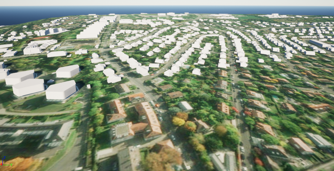

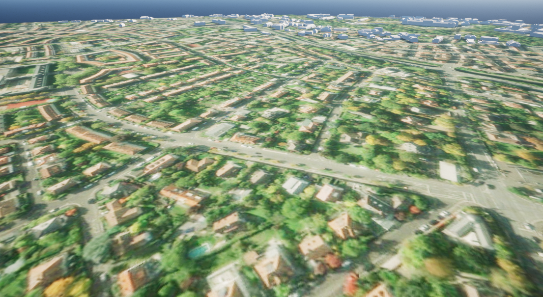

Hallo everyone,
I have downloaded some CityGml data from this website https://geodaten.bayern.de/opengeodata/OpenDataDetail.html?pn=lod2 . I converted the data using this toolbox https://www.arcgis.com/home/item.html?id=7f765465648049d5a93ef2dc05b1f52b in ArcGis Pro. I loaded the data local through a layer. Now in some camera angles buildings are disappearing. No matter if the buildings are far away or near. In theory a 3D Model should be on every house.
