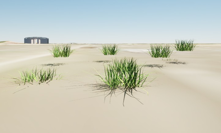

During real-time runtime spawning, the cloned foliage actors fail to consistently snap to the ground — some sit on the terrain surface while others spawn underground. I suspect there is an issue with the calculation logic of the On the Ground property described in Step 4, and its ground alignment effect does not take immediate effect.Generate GrassGenerate Grass

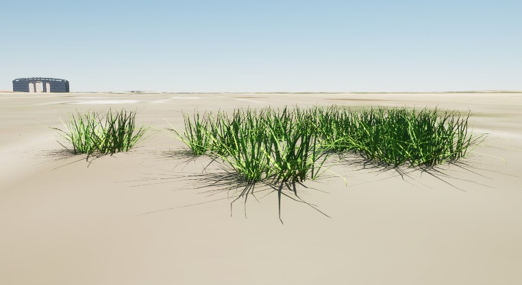

This is because after closing and restarting the program, when initializing foliage clones by loading the saved JSON coordinates, the ground snapping function of the location component works properly as expected.
Initialize GrassInitialize Grass

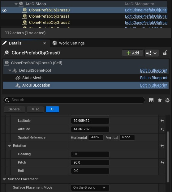

I confirm every actor has an ArcGISLocation component.
Grass BlueprintGrass Blueprint
