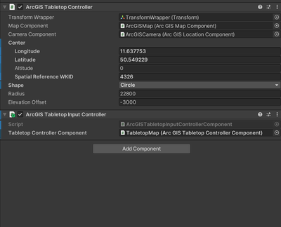

Hi,
I'm using the TabletopMap example. I moved the TabletopMap asset to a position away from the origin. When I zoom in and out, the y position of the map changes. How can I avoid this?
I also do not understand the "Elevation Offset" and the Arcgis Camera. Where can I find documentation about this?
I use the Spatial Reference WKID 4326.

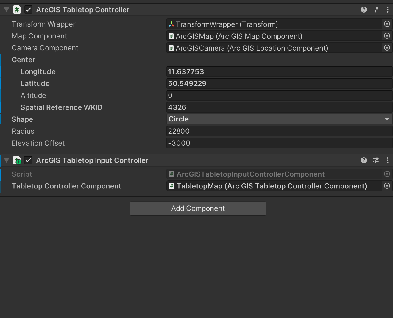

Settings:

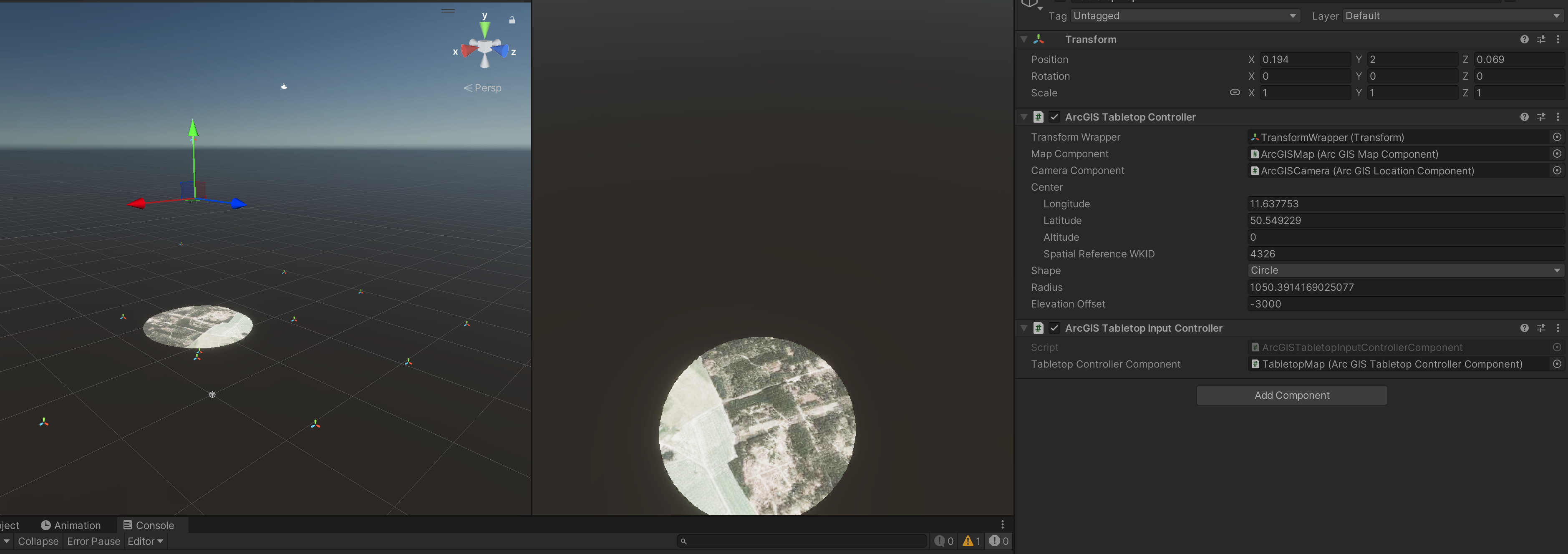

After start

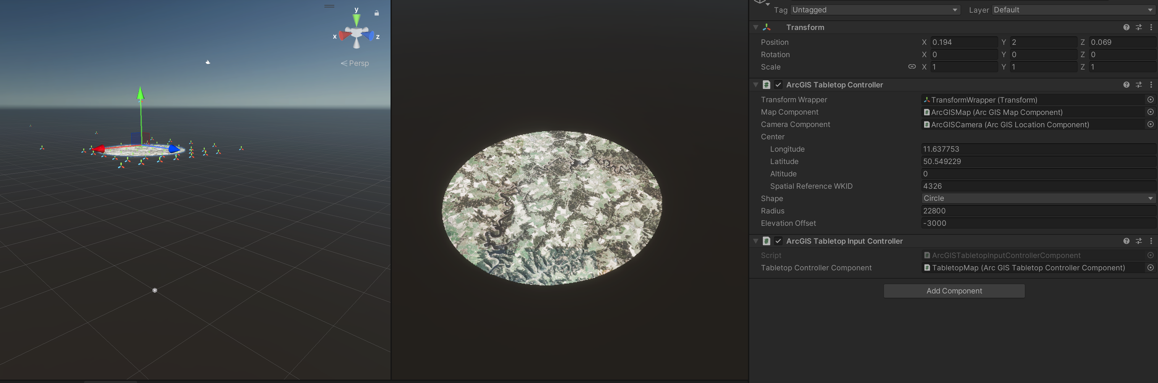

After zooming in
As you see, the map moves down in y position when zooming in.
Thank you,
Manfred

Hi Manfred. Elevation Offset is used to move the map downwards when working in high elevation areas. I recommend starting with an elevation offset of zero. Then, adjust the elevation offset to work best with your extent.
I hope this is helpful,
Zack
