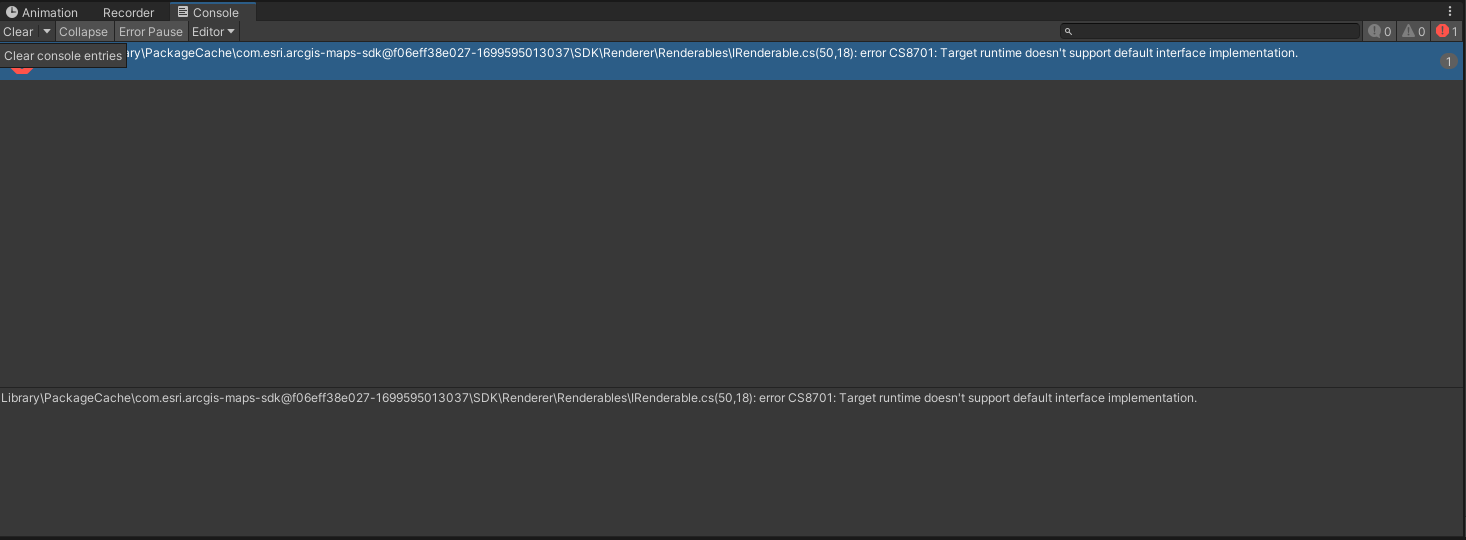

Hello,
I'm facing a problem with my existing Unity project which was built on legacy render pipeline. I converted it to URP and install SDK for Unity. I'm getting this error:Screenshot 2023-11-13 075721.png
Maybe someone encountered the same problem and know how to solve it.
Thank you!

Solved. Just updated my Unity projects version to newer and it's working.
