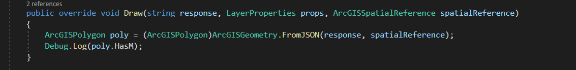

I've tried to make it work using ArcGISGeometry.FromJSON():

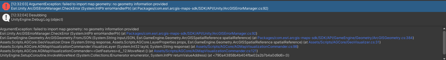

However that throws the following error:
Im simply passing the downloadHandler.text as the json, so maybe it needs some additional processing before going in. The source of the data is a feature layer.
