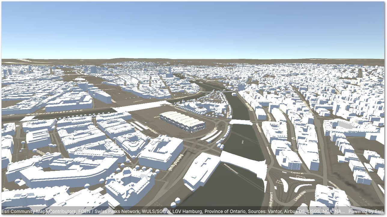

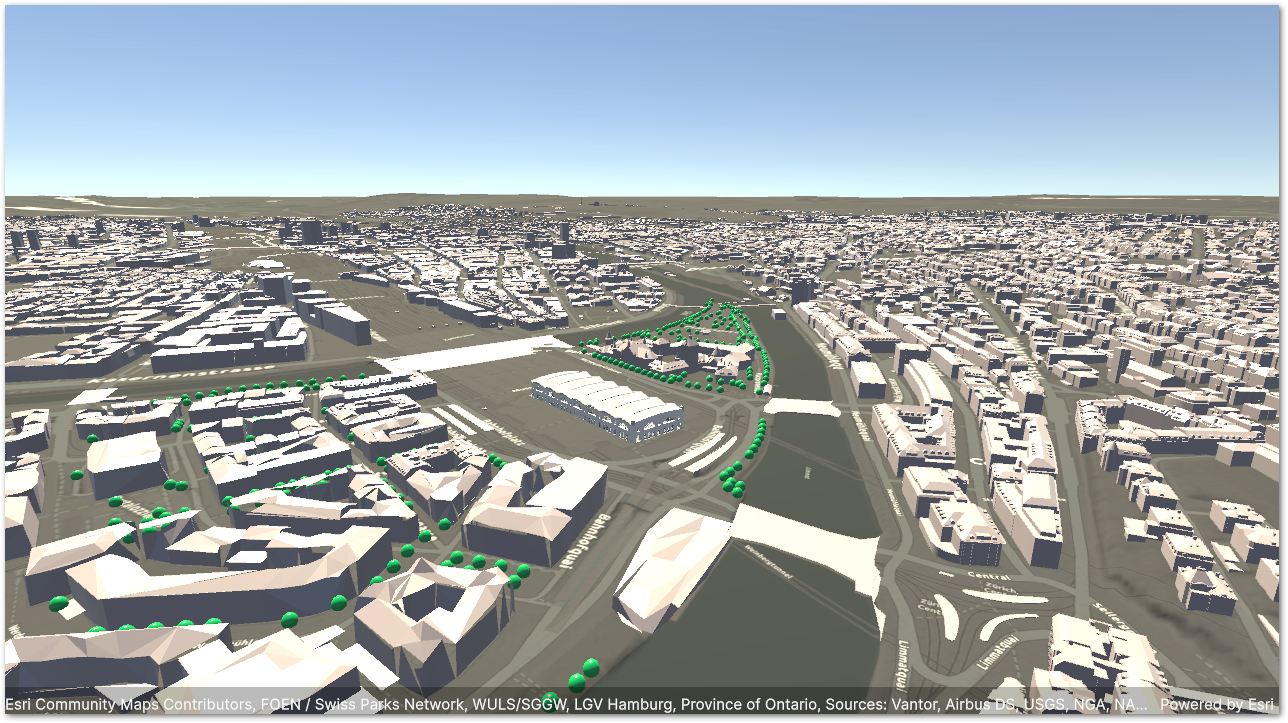

This works perfectly fine in 2.2 (the trees are green, using the sourced green material) but this doesn't work any more in 2.3 (trees are white)
Please check out the screenshots to see how this is rendered in Play Mode
Version 2.2
Version 2.3
It looks like something has changed between 2.2 and 2.3
