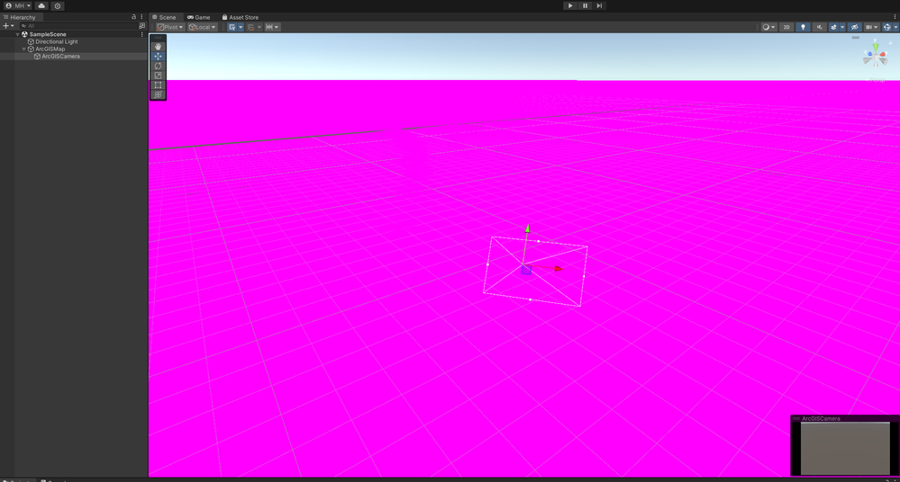

Can only see pink texture
1604
06-19-2024 01:11 AM
MalteHernandez
Im trying to do one of the first tutorials in the guide for the ArcGIS Unity SDK and after pasting in my API key I get this as a result, I have tried selecting different Basemaps but nothing is working, this is currently when using the Imagery Basemap.
This iis the guide Im using Display a map (UI) | ArcGIS Maps SDK for Unity | ArcGIS DevelopersScreenshot 2024-06-19 100834.png

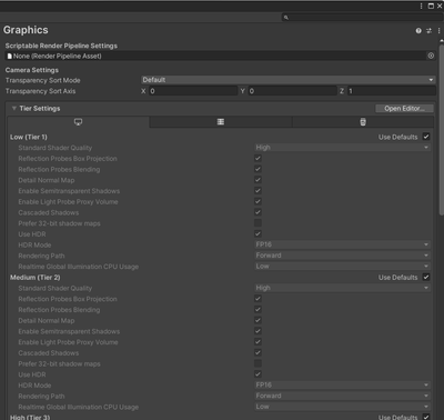

What rendering pipeline are you using?
MalteHernandez
It says none. I dont know how to add one
