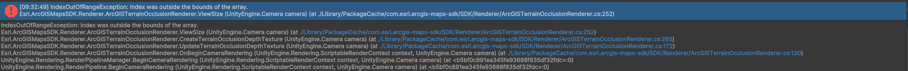

If we add a Camera targeting another Display the ArcGISTerrainOcclusionRenderer throws IndexOutOfRangeExceptions:

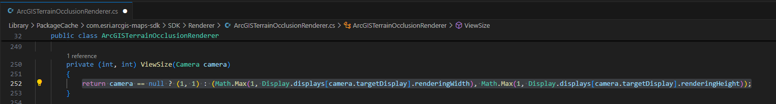

this is the section causing this Exception:

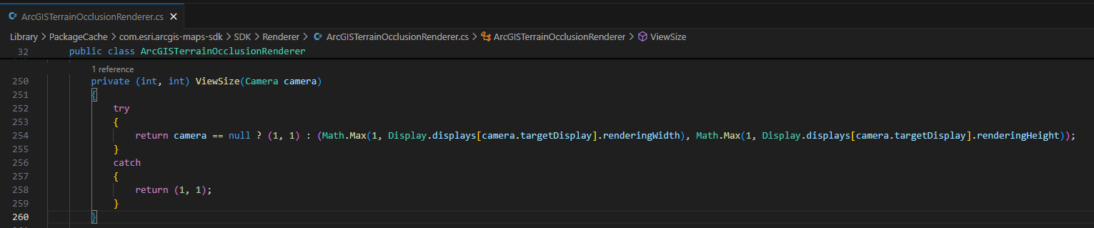

We temporarily fixed it like this:
And that works for us however we need a proper solution. Everyone having to apply this change in the PackageCache manually is not good at all.
