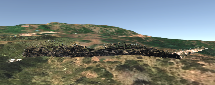

Hi, I have noticed a problem when using an Integrated mesh layer in ArcGIS Unity with URP. As can be seen below, the entire layer is still visible while I'm behind a mountain which is a problem. Is there anyway to hide the layer while the player is behind the mountain?

This is a bug. We will look into it. Thanks for reporting it.
