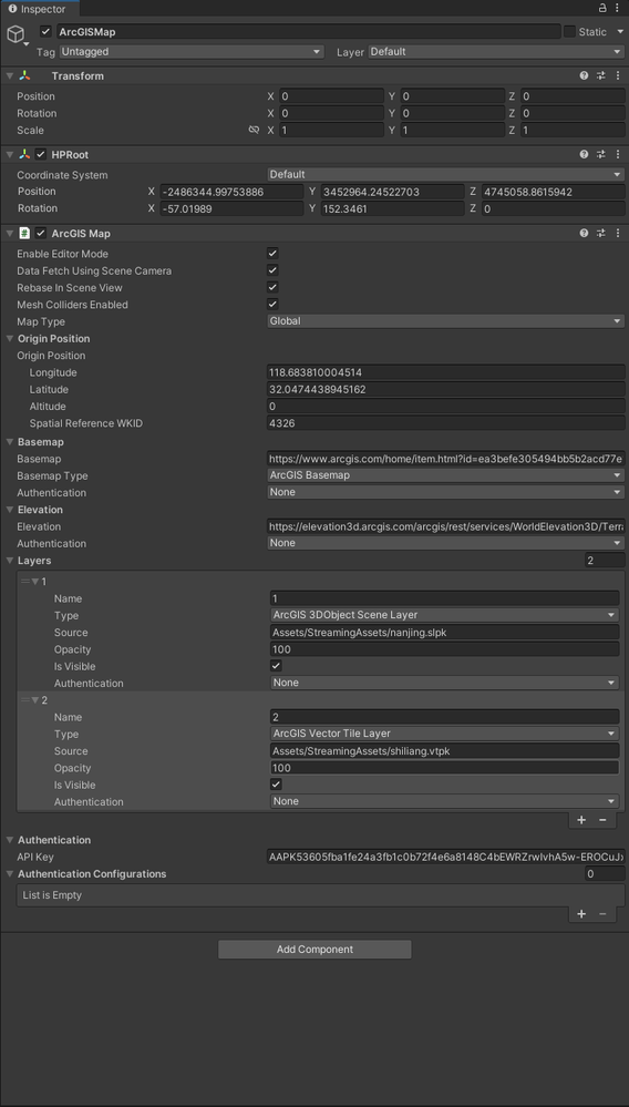

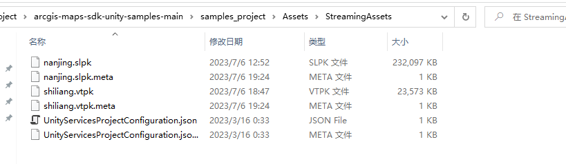

  • As shown in the figure, two types of data cannot be loaded at present

In the source field, you have Assets/Streaming/.....
Try to use a full directory to locate your local .slpks and see if that works, for instance C:/Assets/Streaming........
