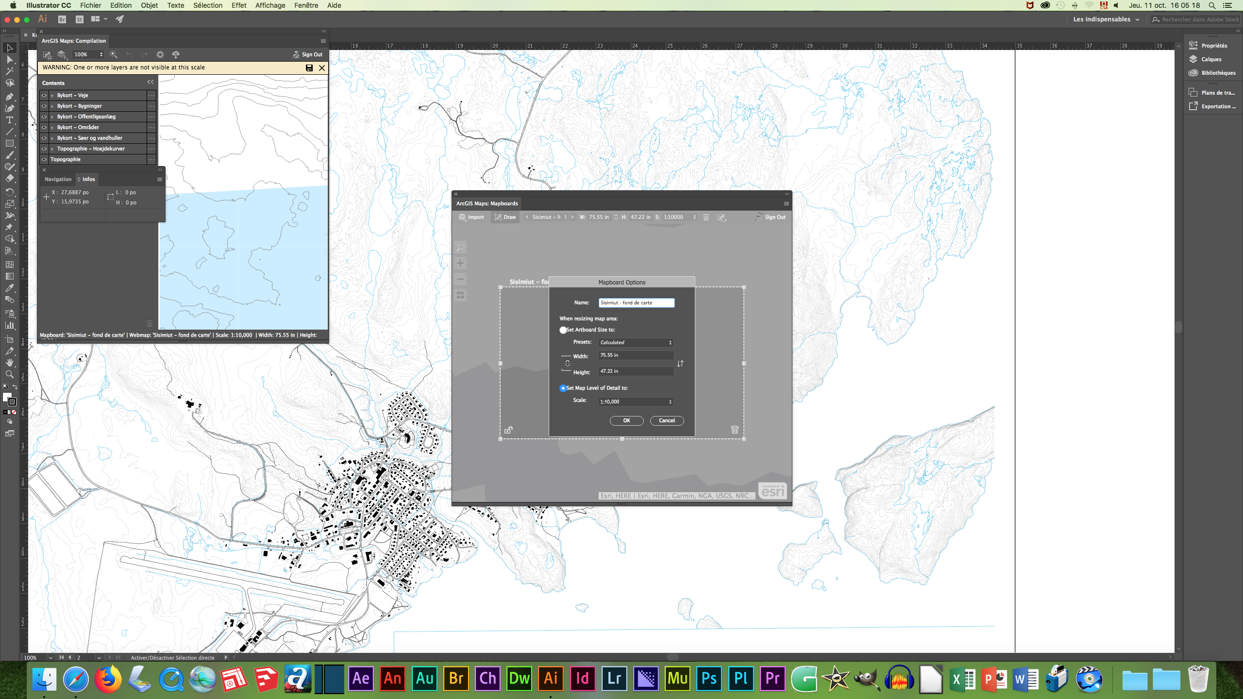

Hi Sarah! Thanks for answer. Yeah I understood that setting while I was experimenting with the extension yesterday.
I just ran another test. Like you'll see in the screen below, I made sure that Set map level of detail to was ticked and set to 1:10000 under the When resizing map area setting before importing.

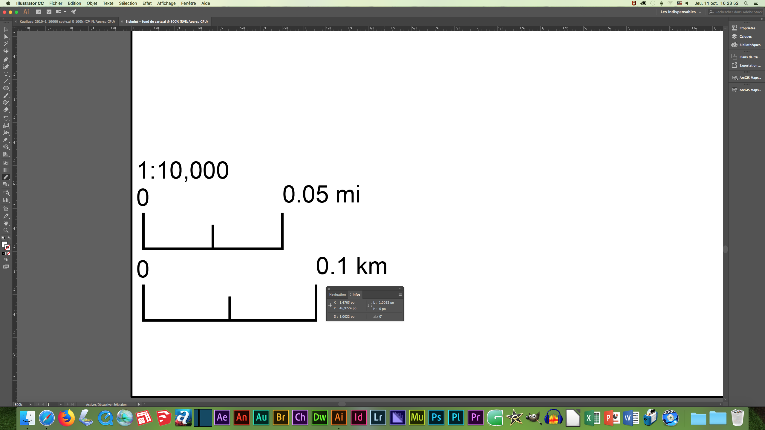

After the import, when I mesure the scale displayed at the bottom left of the map, here's what I have.
Since the map's scale is 1:10 000, the 0.1 km scale should be 1 cm long on the map. And as you just saw, it's roughly 2.55 cm.
Since 2.55 cm = 1 inch, I'm wondering if there's some compatibility issues due to the fact that my OS system is not in imperial unit, but in metric (with French Canadian settings). I know it can create some compatibility issues sometimes, because the comma and the dot are not used for the same thing when displaying numbers (it can create problems with CSV files and stuff like that).
What do you think?

Hello Sarah, I did some measurements on my map, to be sure. It is not only the scale bar that is not at 1:10 000 but the whole drawing. I measured a building in Illustrator after the import and then compared it to the measurement from ArcGIS online. The building in Illustrator isn't 10 000 times smaller, as it should be.
