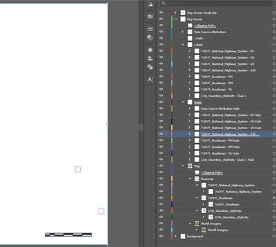

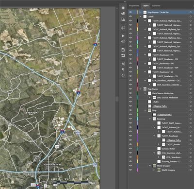

Like the title says, I edit maps in illustrator on a daily basis. The layers are always in the same order when i open the AIX in Illustrator. Monday I got a new laptop and now the halos for higher markers are stored in another layer, additionally a specific highway marker layer contains a clipping mask that covers the world imagery layer.
On my juniors laptop, I opened the exact same AIX file and the layers are structured properly.
Juniors laptop:
 My new laptop:  the aforementioned clipping path is in the highlighted layer.

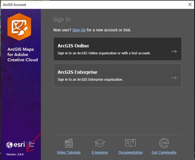

Hi, I will investigate what is causing this issue. Thank you for providing details on your workflow and computer environments. Can you also tell me which version of ArcGIS Maps for Adobe you are running on each laptop? It is visible on the bottom left corner of the sign in screen.
