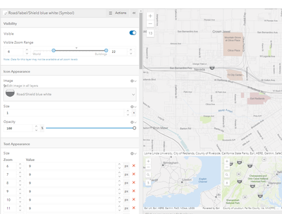

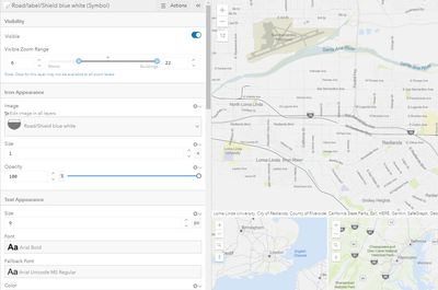

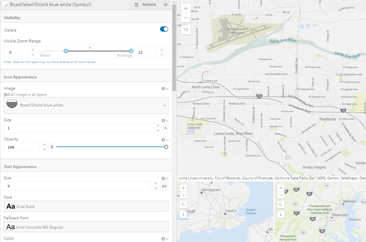

Hello, I made a basemap style using Esri's Vector Tile Style Editor for our organization. On the web map preview, I can see the highway symbols I made are rendering the selected font, Arial Bold, at 9 pt (correctly). This is set to be the same at all numbered zoom values.

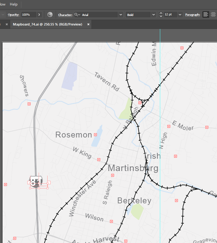

However, when loading the basemap in to a mapboard when syncing to ArcGIS Maps for Adobe Creative Cloud, the font of Arial Bold loads, but the point size always renders at 12 pt (regardless of selected scale) and obviously dwarfs the symbol graphic.

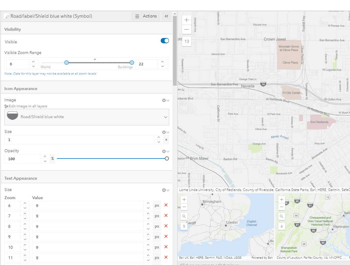

Thinking that maybe this was something to do with the map scale and symbol scale getting weird, I went back to the Vector Tile Style Editor and instead of setting for all zoom levels, I set all visible levels (which was 6-22) individually to 9 pt, thinking it would override any scaling issue (even if it was clunky).

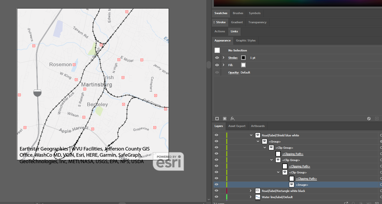

With that test export (a duplicate of the exact same test mapboard above), it went worse - the text didn't render at all. Even deeply nested in the several clip groups, only the symbol image itself rendered (see layers).
