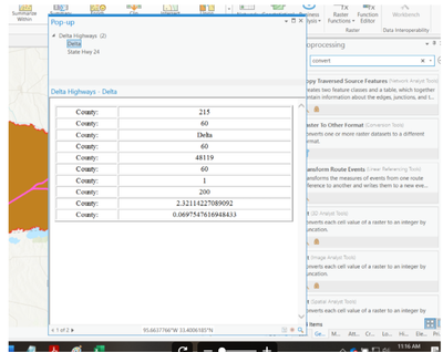

Hi @MikelSavage ,  Dose the KMZ file have the same Symbology, and also check the attribute fields, is there any that have a null value where there should be something there?

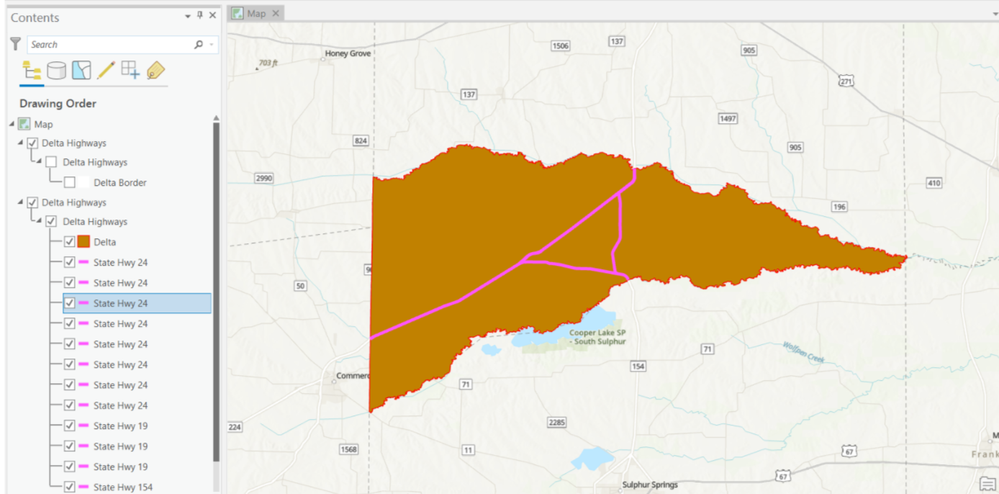

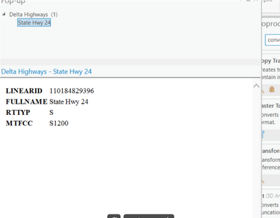

Hi @MikelSavage  I have been able to view the Data in ArcGIS Pro,
has the setting changed since you uploaded the other files?
Have you checked chances or maybe storage?  If you can maybe see if youD map 2.PNGD map 2.PNGD- map 3.PNGD- map 3.PNG
can change the file format? and I am assuming you are using ArcGIS Map? D map 1.PNGD map 1.PNG

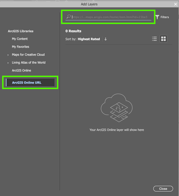

Screen Shot 2021-08-12 at 9.48.15 AM.pngScreen Shot 2021-08-12 at 9.48.15 AM.png
Here is a screenshot of the interface where URL can be added.
MikelSavage
Thank you for the reply with the screen shot. This has allowed me to grab the county. Now I just need the state highways which is where the TIGER-Line Shapefile, 2019, Individual County Primary Roads file came in handy. I used in Google Maps  to import the shp file, assemble the important roads, and package it as a KMZ.
