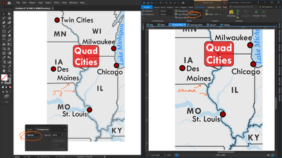

Currently, one has to manually select features and re-apply each blend mode once in Illustrator to achieve the same effects present in ArcGIS Pro on export. It would make sense if blend mode information came along with the export - at least those with an Illustrator equivalent.

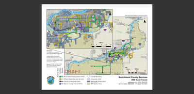

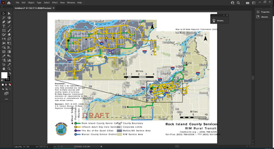

@Xingdong_Zhang  I am still experiencing issues with this in 3.2. Layers with blend modes applied appear to be converted to raster images when exported. It actually appears to be converting whole maps into raster. In the below example, I have two maps, one of which was entirely outputted as raster and the other as a partial vector. The vectors are the layers that do not have blend modes applied.
Map in Pro:

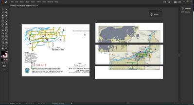

Map in Illustrator - removing the raster image portions, you can see that the bottom right map is entirely raster in the output, and layers with blend modes in the inset are also raster:

In ArcGIS Pro blend modes, there are a few exceptions that are not available in Illustrator. Could you please check if the blend modes you applied in ArcGIS Pro fall in the highlighted list below? Unsupported blend modes could trigger rasterization and end with an image rather than vectors. If that is the case, you try a supported blend mode to avoid this issue.
* Visual effects-When you apply a blend mode in ArcGIS Pro that's also available in Illustrator, it's preserved in the exported AIX. If you apply a blend mode that doesn't have an Illustrator equivalent (such as Linear Dodge, Linear Burn, Linear Light, Pin Light, and Vivid Light), the applicable layer is rasterized (with all layers beneath it) and flattened into a single image in the .ai file.
