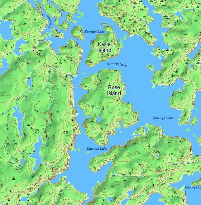

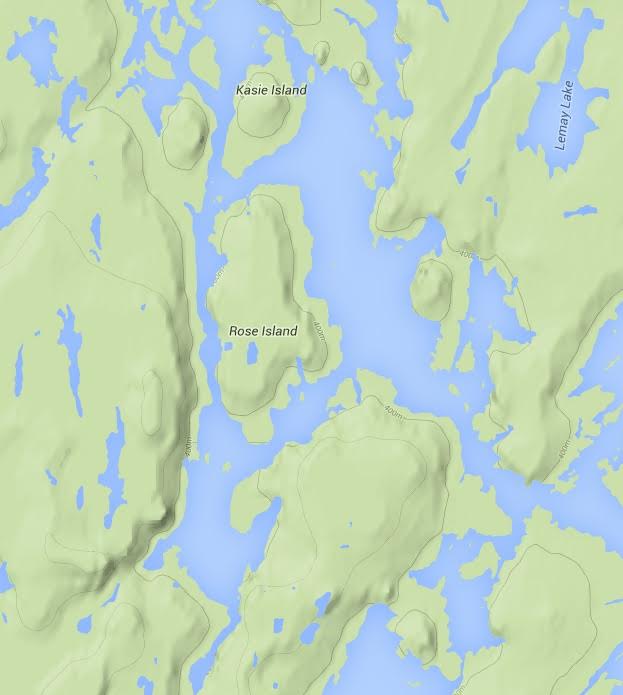

The images of below are from my map and from another online topo map.  ​A​ll the maps I have checked ​show ​Rose Island ​long and skinny like it does in ​the​ first ​​map​ below​. I think the Coordinate Reference System (CRS) or the Projection on my map is not correct.  I am using ArcMap   If I change the CRS, to UTM NAD 83 Zone 15, then Rose Island will look like it does on ​the ​first map​, however, the data source ​says that the CRS for the data is:  NAD83 (EPSG:4269)  EPSG   which is what my map is set to.

I would think that the information supplied with the vector data specifying the CRS would be correct but the shape doesn't seem right.
I assume all the online and printed maps that I have checked are displaying Rose Island in the correct long and skinny shape.  Should I change the CRS on my map to make the Island look the way it does on other maps?
Also, I am new at this and I'm not sure what the difference is between CRS and "Projection" are they the same?  Or, maybe I have the CRS correct and the Projection wrong?
           All the printed and online maps that I checked show Rose Island as below.
         Below is my map with CRS GCS_North_American_1983 WKID: 4269 Authority: EPSG
